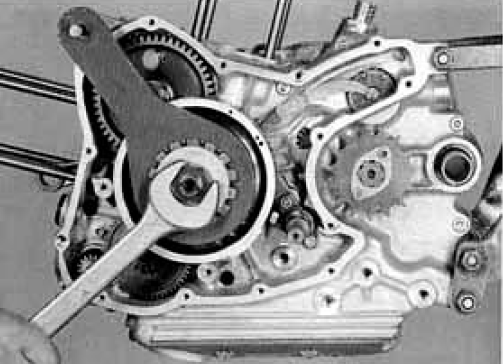

  2. No, the Pantah didn't have a side stand but I've wondered about fitting one myself. I don't think it would be difficult to adapt the stand from a later bike to suit. If you look at the LH crankcase there are 3 M10 threaded holes. The same holes are used on many of the later Ducatis to mount the side stand lug. It should be possible to fit the lug from maybe a 900/750/600 SS or Monster and modify the stand to suit. Possibly altering the length or putting a crank in it is necessary.

  3. Something went wrong trying to load the photos but you'll get the idea
