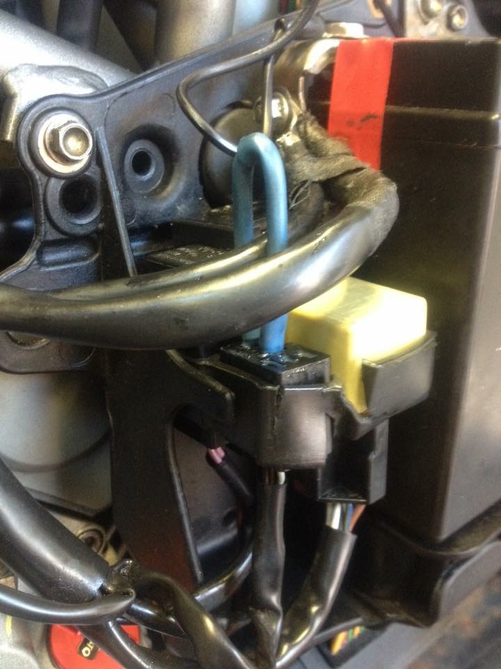

  6. Not sure why most seem to recommend removing the relay or removing the switch plug and sticking a wire loop in etc etc here, can anyone explain?

  7. The wire works well because its very easy to reverse if wanted.
  8. If you loop the wire at the stand switch your relay can still play up
