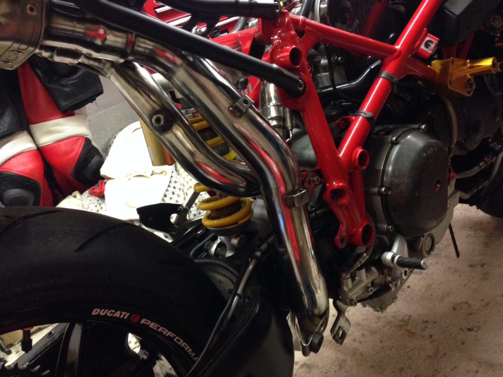

  7. image.jpg It's pretty straight forward to changeover the silencer. Remove tank, seat and rear cowl unit as one. Remove rear lights and indicators. Remove bolts holding silencer to subframe. Remove subframe, exhaust retaining springs and then wiggle the silencer off the exhausts. Make sure the metal gaskets are on the exhausts when you wiggle the new silencer on and refit everything in reverse.
    On the ECU swap +1 @final_edition s advice on the earth wire. Took me a while to diagnose I'd loosen mine and bike wouldn't prime the fuel system and got an error code on the dash.
    Oh yeah and maybe an opportunity to give it a good polish
