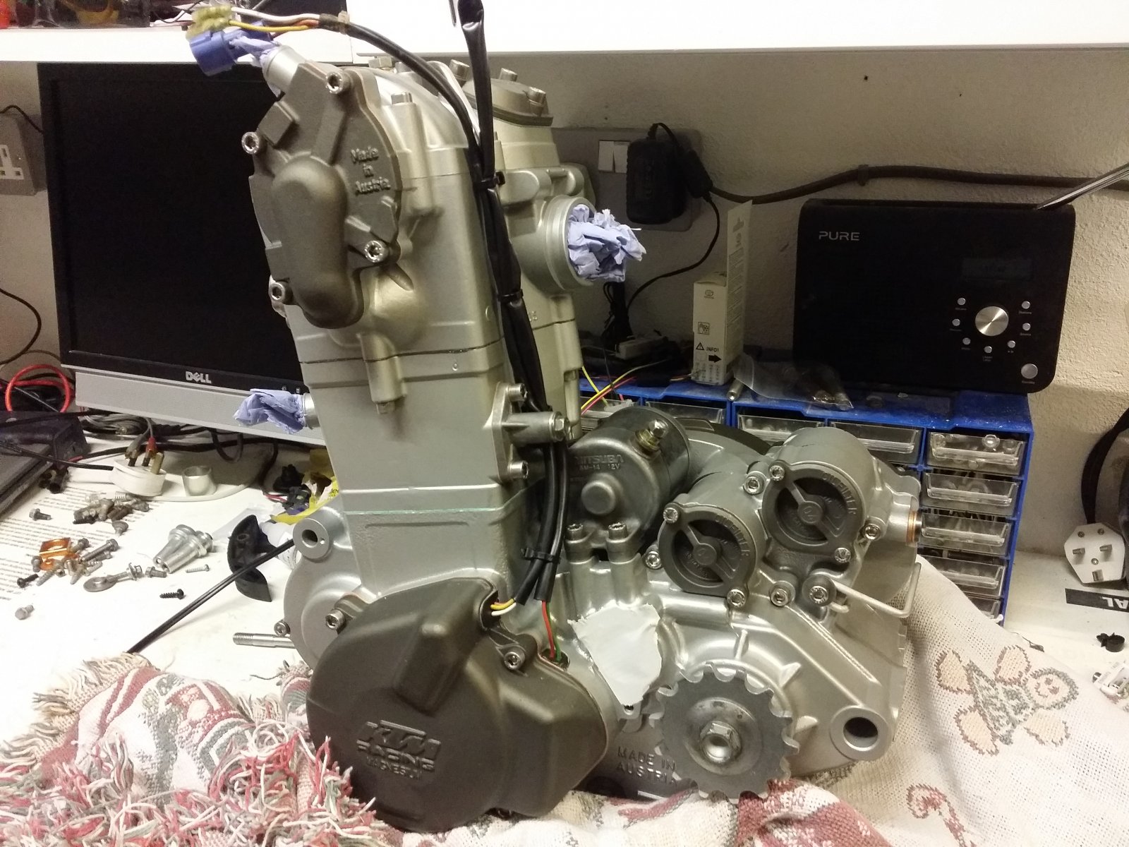

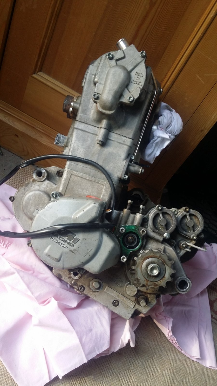

  16. Here's the motor before.....
    Here it is after....
    I don't have the name of the company to hand but it has to be sent away.... The lad that does it races a sidecar so loves his work.... Its available in the usual colours.... That cost 600 quid but nothing will lift it...
  17. Found the place.....
    Sandwell Shot Peening & Specialist Xylan Coatings
    I only found out about them from my mate who has all his engines done there his last one was in pb last year (xr69)
    Really nice bloke.... Most of the cost comes from the preparation. Mine cost as much as a gsx1000 motor as it was more complicated.... As i say.... When my next hyper needs to come apart that's where it's going.... It'll be a revelation to own a ducati engine that won't peel when it gets slightly cloudy...
