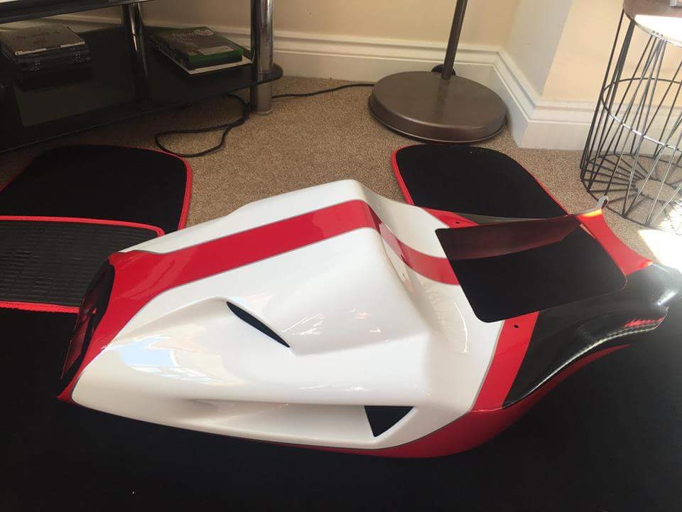

  3. Here’s the one i picked up from ebay for roughly £150 it isn’t a genuine seat but fits rather well, the tell tail signs of it being a ‘fake’ are usually the the writing on the side as a genuine one would usually say Ducati 748.....ect. You’ll also need a seat pad to finish it off with as the biposto seat are a little shorter at the back. As you can probably make out this one didn’t have any mesh in the vents but that was quickly sorted using some body repair mesh Keep searchingpal and i’m sure that you’ll find something suitable. CF45965B-706B-48B9-983D-E1E37A329079.jpeg 049BBA6C-9A37-42B4-A083-16B30B5088C7.jpeg

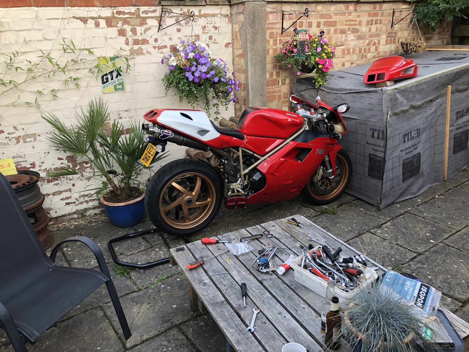

    Get a genuine one if you can afford it/find one. Here's mine for my 998 in c/f by MS Production, fresh from the painters and prior to fitting the vent grilles, lights and the seat pad. The quality will be leagues ahead of the non-genuine ones and if you can find c/f the weight saving is enormous; together with the monoposto alloy subframe iro 10kgs!
