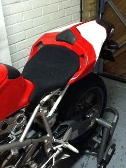

  11. Just fitted the new seat and it looks great. Followed guidelines from "Streetfighter900" and it all came together perfectly. Now for the better weather to try it out but it felt great in the garage :). I also took the seat back one notch to see if that gives me a little more air ! Thanks again for all your helpful comments. Cheers.....
  12. 900streetfighter ... Sorry, finger and brain trouble ..... It's bloody cold out there this afternoon ....
  13. Pictures please :tongue:
  14. Garage a bit dark now but light enough to get an outline shot.... Cheers, Smartyn

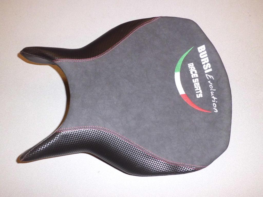

    Sella alcantara carbonio per Ducati 749 999
