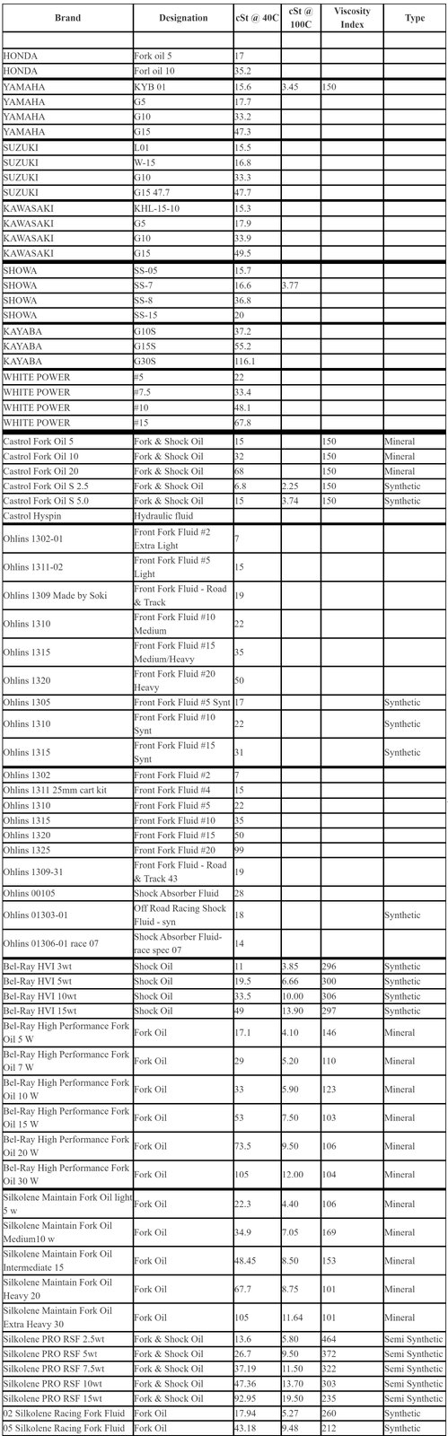

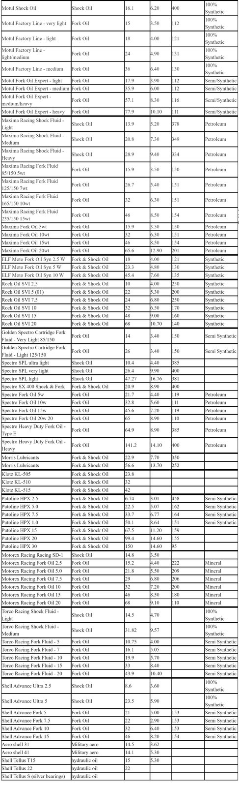

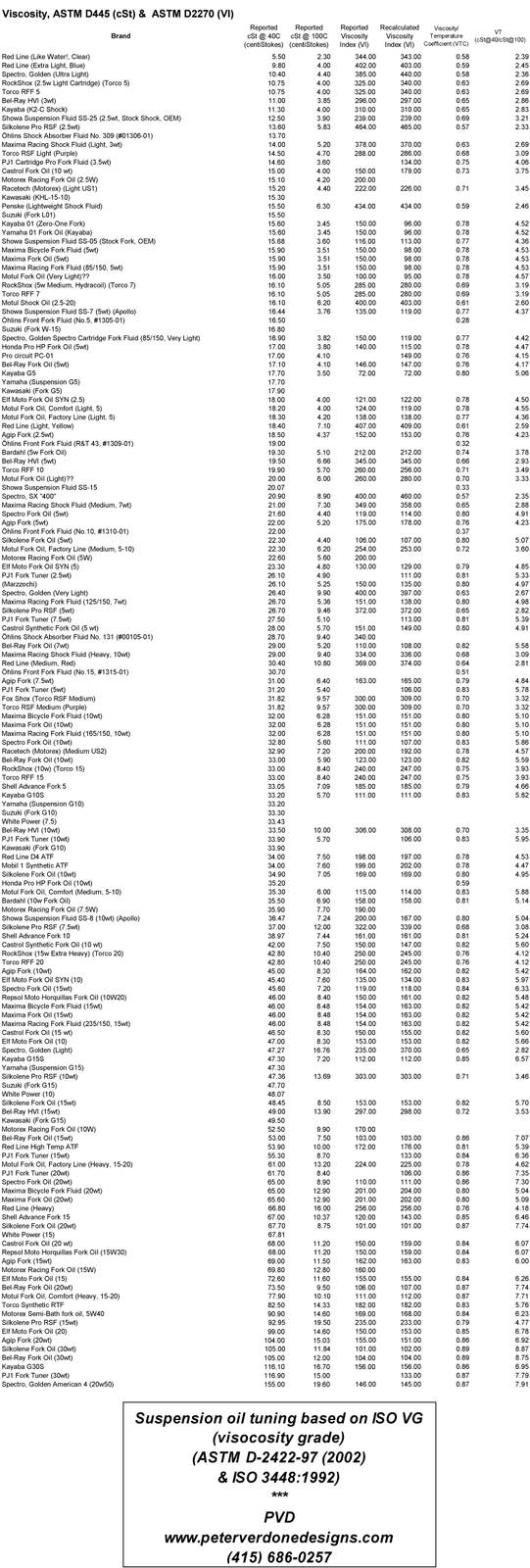

Good post Fork oil is ostensibly rated the same wa engine oil is, which is all to do with how it operates across a vast temperature range (even though it’s a single grade not a multi grade). However, the oil in the front forks doesn’t experience such temperatures as in an engine and what’s more important is it’s viscosity at a certain temperature ie the temperature your bike forks mostly operate at which is different in different climates. What’s of more importance is how easily or not the oil can be squeezed through the valves. This is what’s known as its kinematic viscosity and is measured in what’s known as centistokes. The easiest way to think of a centistoke is how many grams of oil can be squeezed through 1 square millimetre of an orifice (ie the damping valves inside the fork) per second. There’s a useful article here which compares many of the different fork oils out there. https://motoiservices.com/en/suspension-oil-equivalence-chart/
West Cork Paul - I saw a guy demonstrating that, as simple as a cup with a 1mm hole drilled in the bottom, he was timing how long each manufacturers oil took to drain the cup of 100ml of oil, the difference in time took between the same weight oil from different manufacturers could be considerable.
