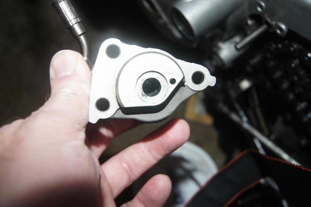

  7. image.jpg Sorry if photo not much help clutch was working fine until sprag went then went solid thanks for all the help so far
