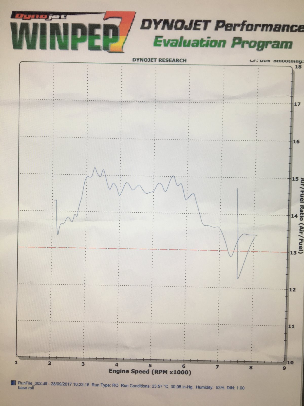

  17. Had my bike Dyno tested today just to see what was going on, even though it seems to be running very well with the new pipe.
    It is running on the lean side although not dangerously high but still think I may get the Power Commander fitted.

  18. Unfortunately the file won't open correctly, at least not on my iPhone, could you photograph the results and upload the photos?, I had my XJR1300 dynoed and that was tending towards a lean condition but the tester said not dangerously so and recommend that I left it as it was.
  20. That is what the 'tester' told me but when you get advice from other people they say 'its lean so get a power commander or a new map'
    Please see a reply from somewhere else
    [​IMG]The ideal ( rideability and power , not stereometric) AF rate is around 13.2 /13.6.
    In my opinion the bike is running lean. Its not too bad ... but I'm sure that it is not good.
    You are running over 14.5 from 2800 rpm to 6400 rpms that are the most usual rpm rate when you are riding the bike.
    Curiously over 6000 rpm to 8000 rpm the AF rate is good.
    In my opinion you need to remap or change the A/F rate...
    I am thinking about rapid bike evo and it´s adaptive A/F tune using the lambda sensor...could be the way to go... the question is that I'm not sure if the oem Narrow Band lambda sensor could do this work...
    In the other side, I would like to see the A/F with the home plug installed... that could be enough if you are not looking max performance, only be in the safe zone.
    And other question is about mpg , probably rapid bike is going to look for optimal power and the mpg is going to be quite bad. The question is that the Scrambler tank is not big and range is not bad because of the good fuelling from factory... Booster Plug only works in transitions (accelerations and decelerations) so probably works better for a good mpg...and it is considerabily cheaper...
    For me 3 or 4 hp more is nothing in this kind of bikes... If you need more power...this is the wrong bike.
    I have change the exhaust pipe because of the sound.... if I have to change the ecu or fuelling to be in the safe zone... ok I will do it... but if I have a good ridebility and the engine is in the safe zone, I would like to have a decent range better than little more power.
  21. I guess on balance it's best to get it sorted, it would probably be a concern in the back of your mind every time you rode it if you didn't, more expense as usual but peace of mind, let us know which option you go for, I'll get mine booked in at the dyno next weekend and use one of my other bikes til then just to be on the safe side.
