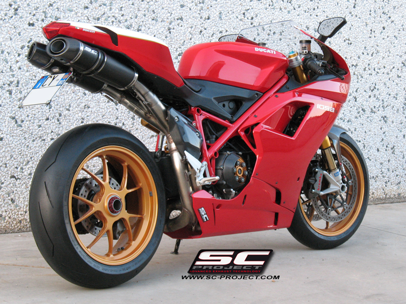

  7. I think if i had an 848, i would fit some of these. All the style of the Termis but a much better finish.

  9. These SCs are nice wish I had seen them before. When I holed a Termi I decided to get something different on my 1098, after all the looking I settled on Quat Ds
    Ducati 848-1098-1198 Coppia terminali
    Helluva site cheaper and a lot better made than Termis, in fact I think almost everything is a lot better made than Termi who trade massively on their name, first and last time I ever buy Termis in any shape manner or form. Just my stupid opinion.
