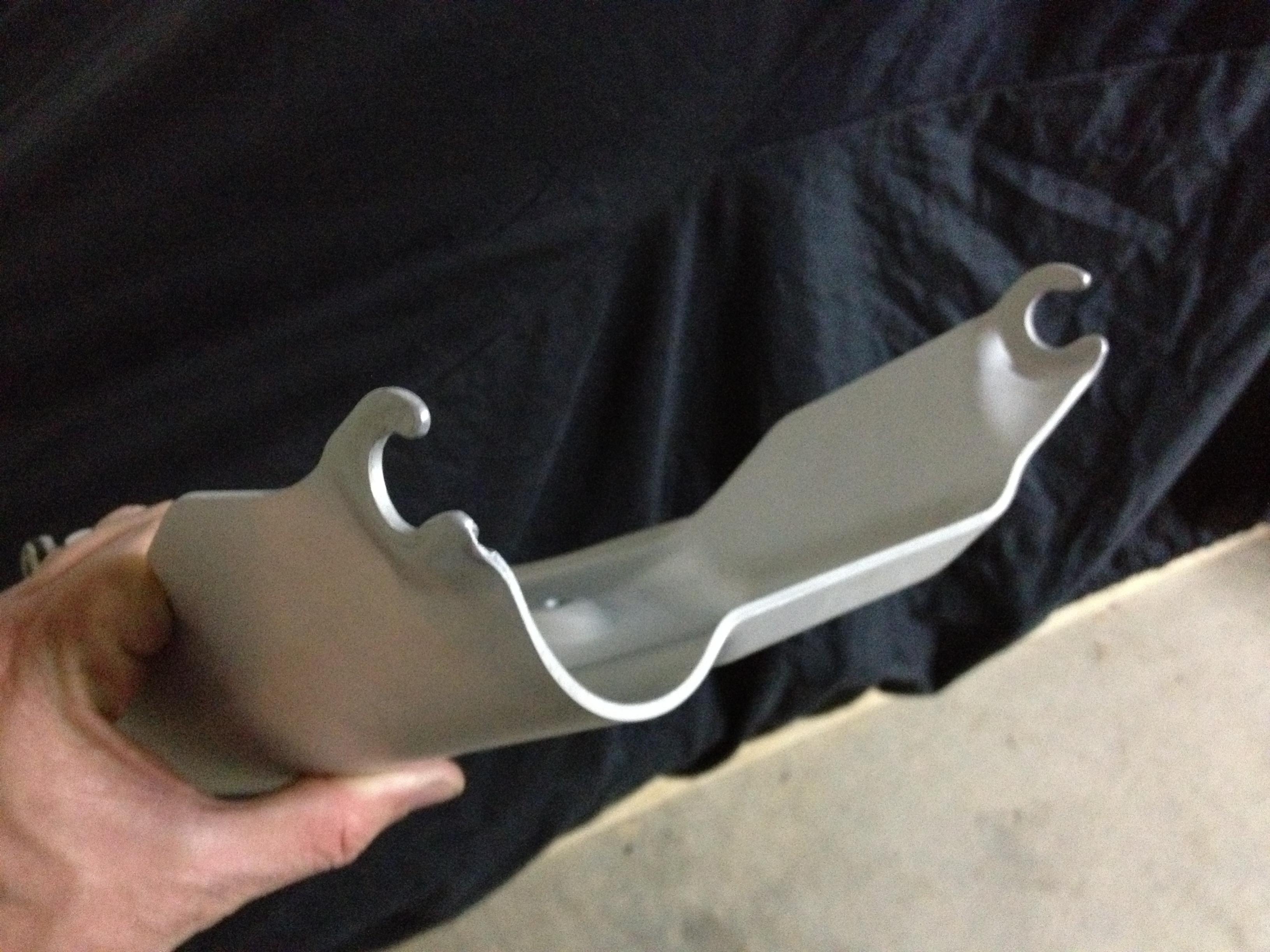

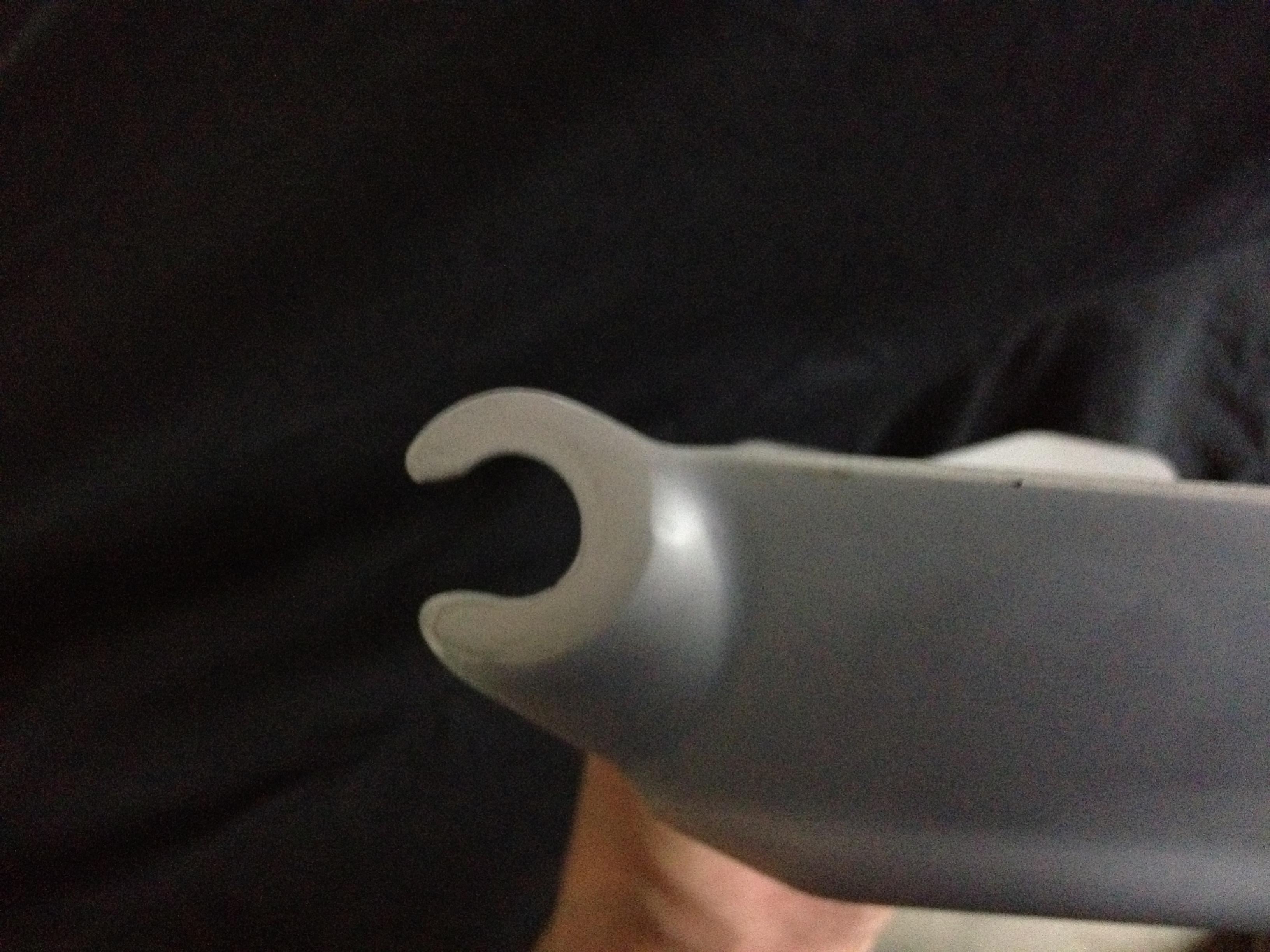

  1. Has any DIY Multi owner slotted the belly pan rear bolt holes to make servicing easier, ie, by not having to remove the centre stand for oil and filter change, cleaning, etc.
    The belly pan bolts look like they can be loosened about two turns before touching the centre stand, and if slotted, would allow the pan to slide forward and off.
    I know the centre stand bolts are very difficult to remove with the Loctite, but it only has to come off once for this project.
    It will also need to be marked and filed slightly both sides with a round file to allow the Allen key clearance in the two bolt heads.

  2. Don I have done this as it's crazy to have to remove the centre stand to do an oil change.
    Integrity of the holes/ slots....who cares....the belly pan bolts straight into the engine so is held on tightly anyway! The slots will prevent any additional fore/aft movement (if the is any).
    Warranty....if such a small mod negates the warranty then one has to seriously consider if warranties are worth it? I cannot believe Ducati would be so pernickety....but admit I am not a legal person.
    Filling....is a good idea to protect the grommets.
    There was a post on Ducatisti or maybe ms with pictures about 9 months ago!
  3. If memory serves when this was done they used shouldered bolts this held the gromets without over compressing them, and then filed the slots to give a lead in when the belly pan is refitted, I think several people carried out this mod so there must be more info around I'm surprised its not an official upgrade/recomend as it saves quite a lot of time and hassle.
  4. Thanks guys for the info. I did a search on both forums and came up with nothing...but hey, you have confirmed my thoughts on the modification being worthwhile, which I will do in due time, as I have just had my dealer do a warranty oil leak from around the filter seal, 7400klms, cleaned up, and NO LOCTITE used on the centre stand bolts by request...(gives me some breathing space) I have a 2010 demo with 5 months warranty left.
