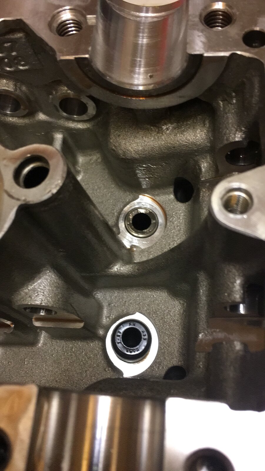

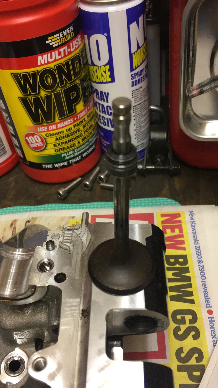

  8. My 1200R monster started doing this, puff of oil smoke at start up, turns out it broke a valve guide, new head under warranty. Was diagnosed by sky high hydro carbons when an exhaust analyser was used. Pics of the head and broken bits, now a nice workshop ornament! 1572D0FC-7A42-4E0C-AD3F-C698ED8150E8.jpeg
