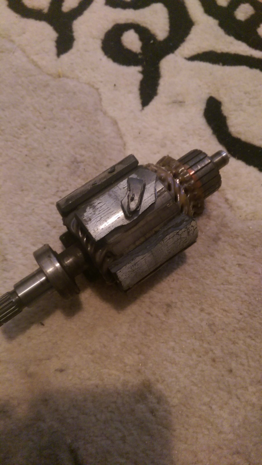

  4. Is your starter motor doing anything? I had a similar problem turned out the windings were burnt & shorting out which just immediately drained the battery, easy enough to remove & strip down for a look if you're getting at the sprag.
  5. Might be worth a look. It's a bugger to start when cold so was trying for a while in short bursts. Then I noticed the cam pulleys just rocking forward and back a few mm. Presumed that the engine was top dead center and the clutch didn't have the grip to get passed it. Then I gave the starter button another prod and the dash went off and came back on when button released. So a burnt out starter motor shorting when tried does make a lot of sense :upyeah:
  6. Yeah you could be lucky & there might be nothing wrong with the sprag, the slow demise might have been the motor packing in over a period of time, if it's gone like mine did it's pretty catastrophic & very obvious :)

  9. Just an update. Pulled the starter motor out and stripped it to find this.
    A couple of the magnets had broken up inside! Thanks Tobytyke :upyeah:
    Quick fix was a new motor from Wemoto, great service.

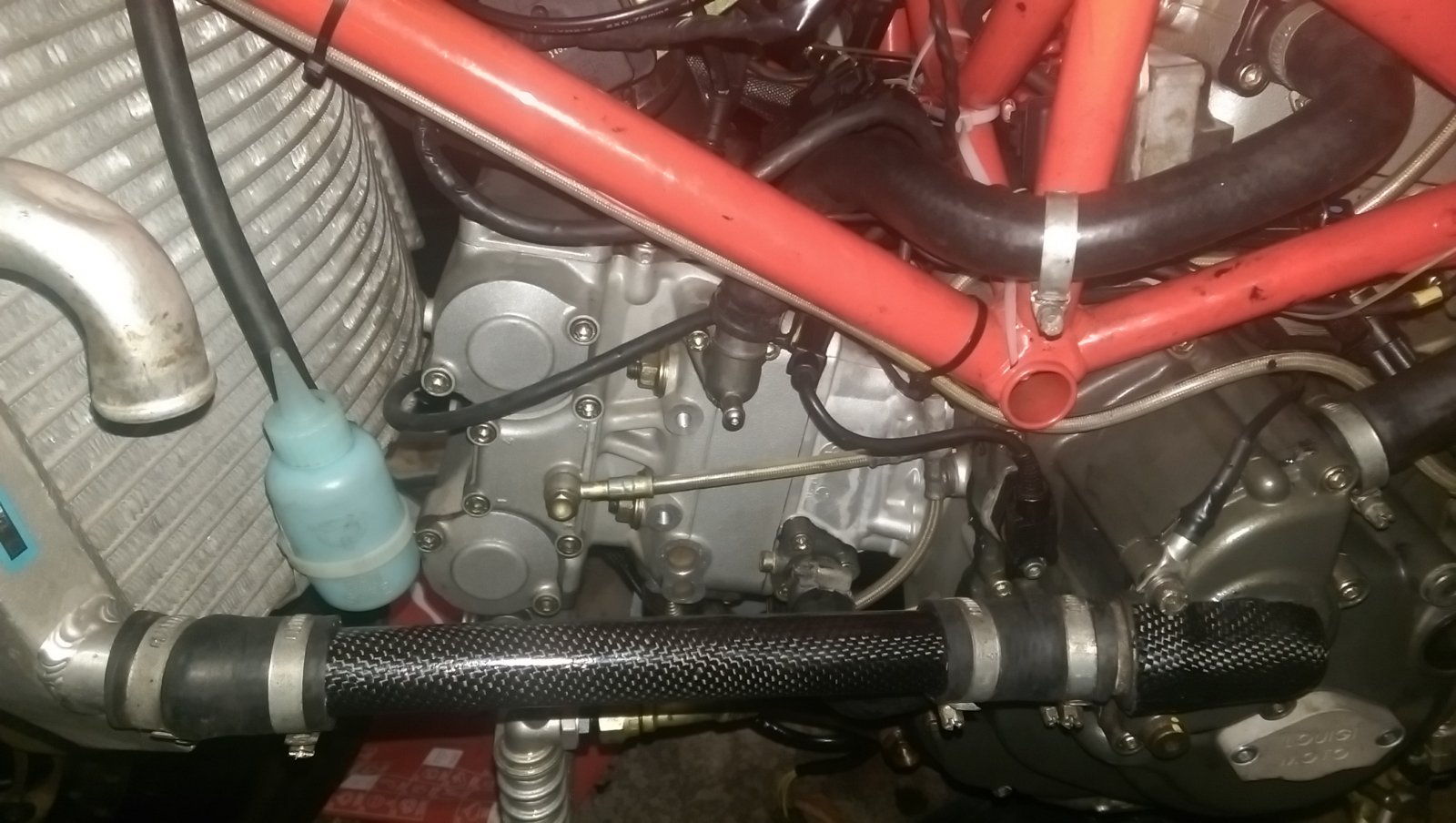

    Half way through the coolant plumbing and already looking neater with only one hose left to fit.

  12. Spent days making a carbon T piece for the top coolant pipes and you can't even see it. Still, looks a bit neater now, and hope will look a bit better when I get some nice silicone hoses on it.
