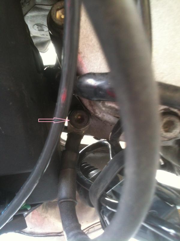

I adjusted the throttle stop screw on the throttle bodies cam a tiny amount on my 9R and it's been great since.
