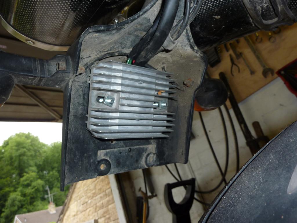

  12. Next job before you put the soldering iron away is to move that reg/rec to the rear and keep it a bit cooler, like this.
    Overheating is a known problem.
    Steve
