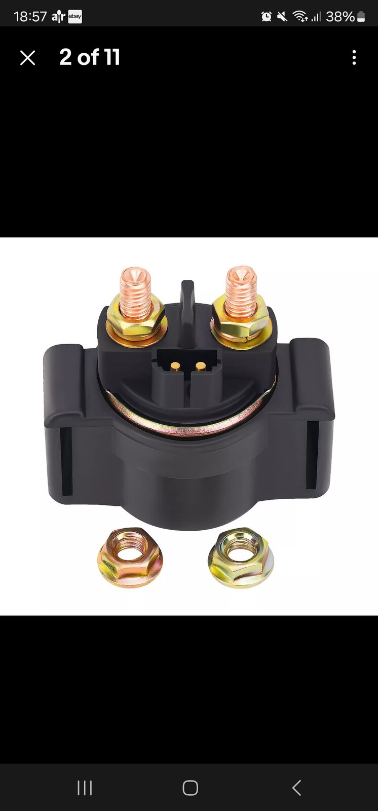

  1. So though I’d go for a spin seeing as the weather is good and I had the time
    Went to start the bike fuel pump jumped into life as usual but on pressing the ignition button a fast buzzing sound could be heard from this little box of tricks and the engine wouldn’t turn over.
    It’s been acting strange for some time now on hot start ups but this is the first time for a non start. Battery reads well and is relatively new, so I’m suspecting the solenoid
    Whipped it off now looking for a replacement
    Any recommendations for a supplier?
    Thanks in advance.

  2. Not seen this relay on any SS, was it fitted to later models as standard? The below is what the one on my bike looks like

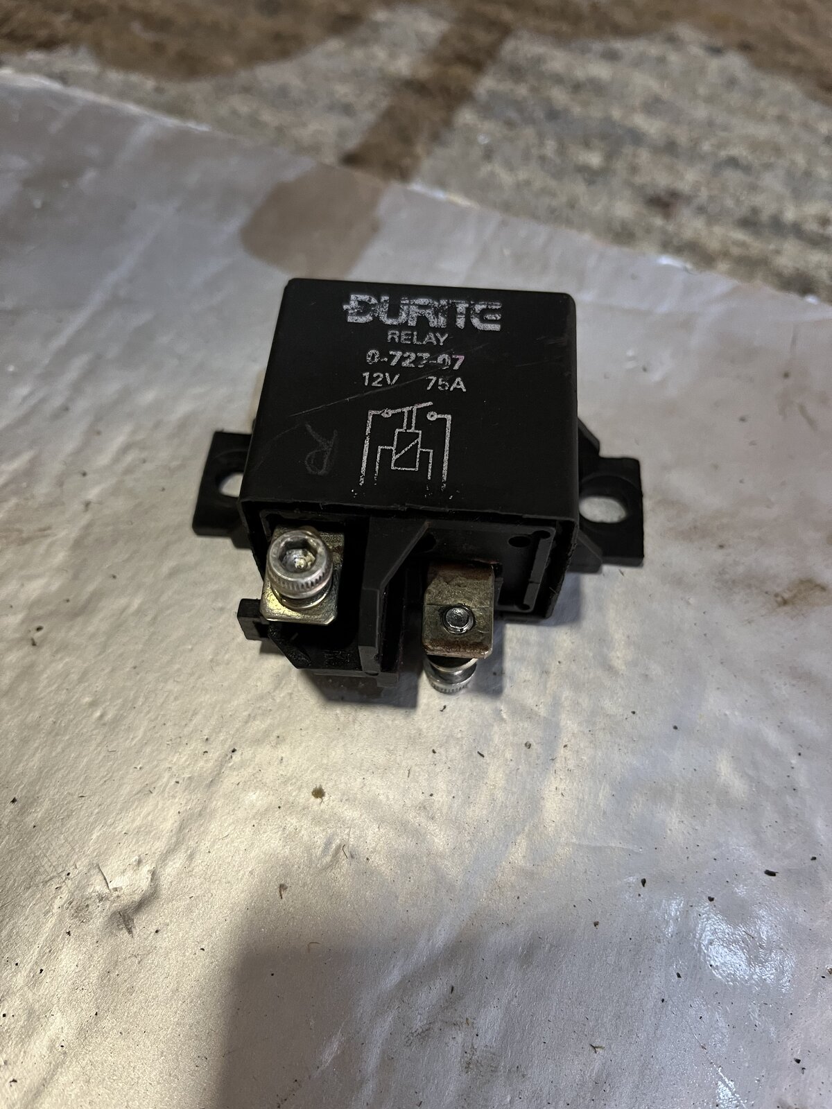

  3. I know I must be missing something:
    https://www.durite.co.uk/072707-12v-heavy-duty-make-bre.html
    As for not being standard, if the values are the same...
  4. Mines an Italian import so may differ slightly
    Thanks @Wasted Time Lord I’ve ordered one.
