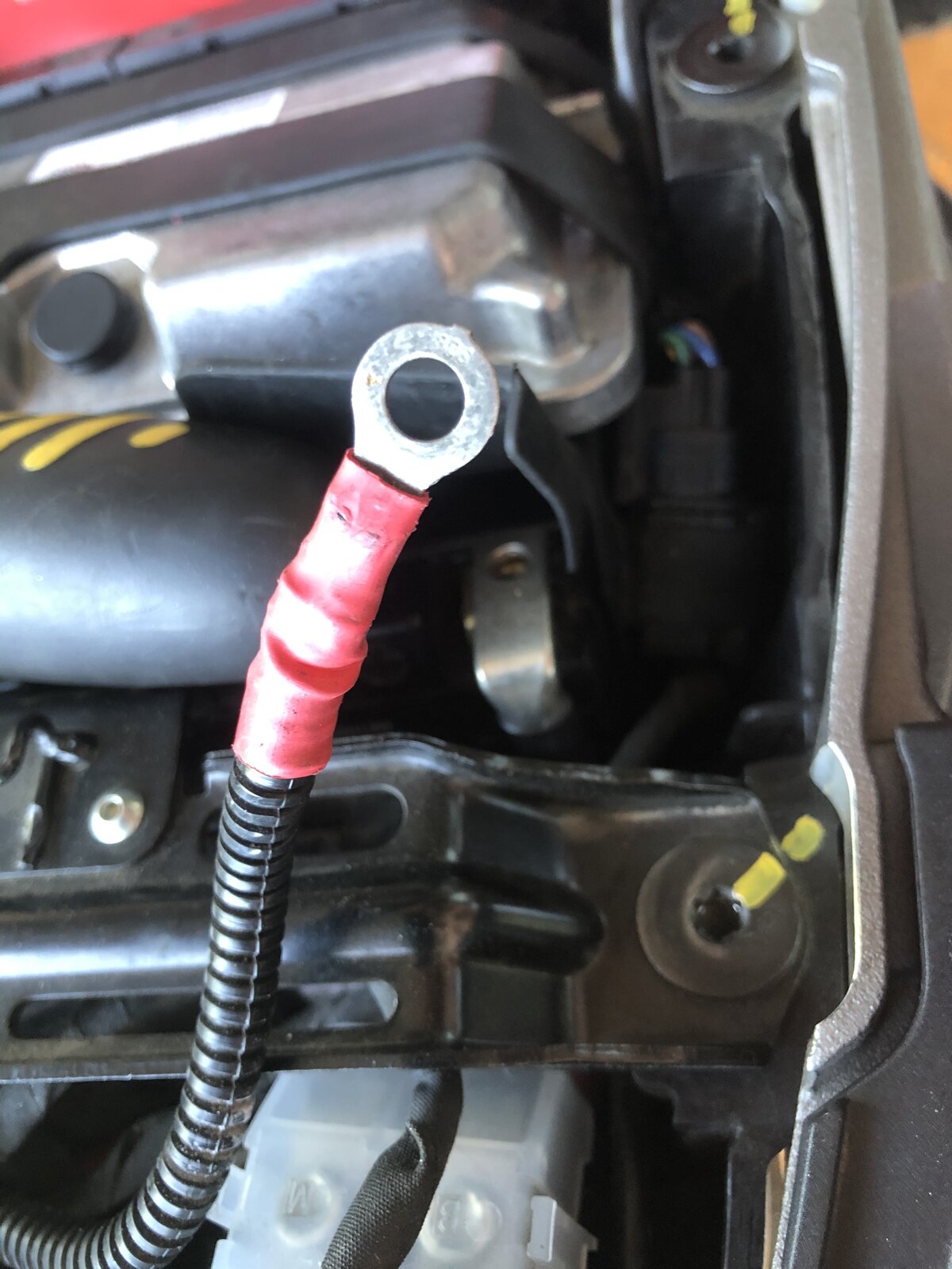

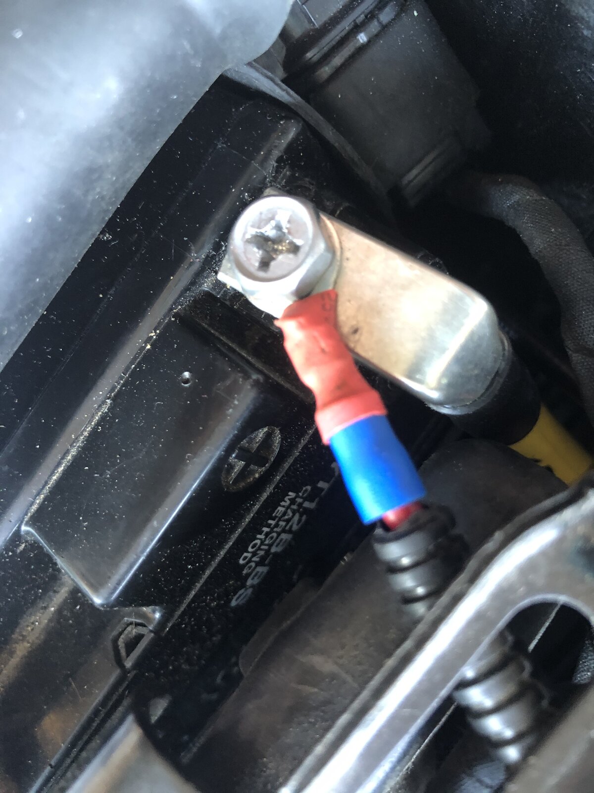

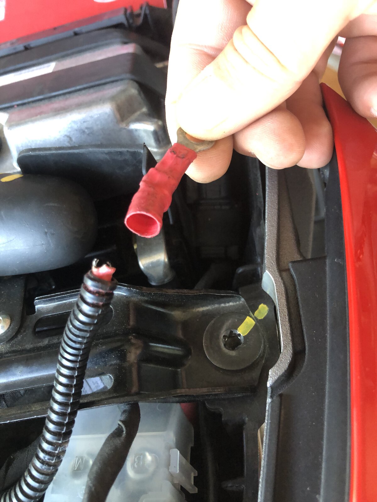

    I ve found the problem with the abs.
    Broken abs cable in its connection to the battery.
    new terminal melted to the cable and new bike again...:innocent:
    LOVE THIS BIKE

  9. Brilliant. So the ABS had effectively become disconnected from the bike. I should have thought of that.
  10. I think the union between terminal and cable was so weak... not completely broken as the abs worked til I brake relatively hard and the abs system started to act. Probably voltage needed was not enought and the control module detect this, shut down and the abs light and error appears on the dash
