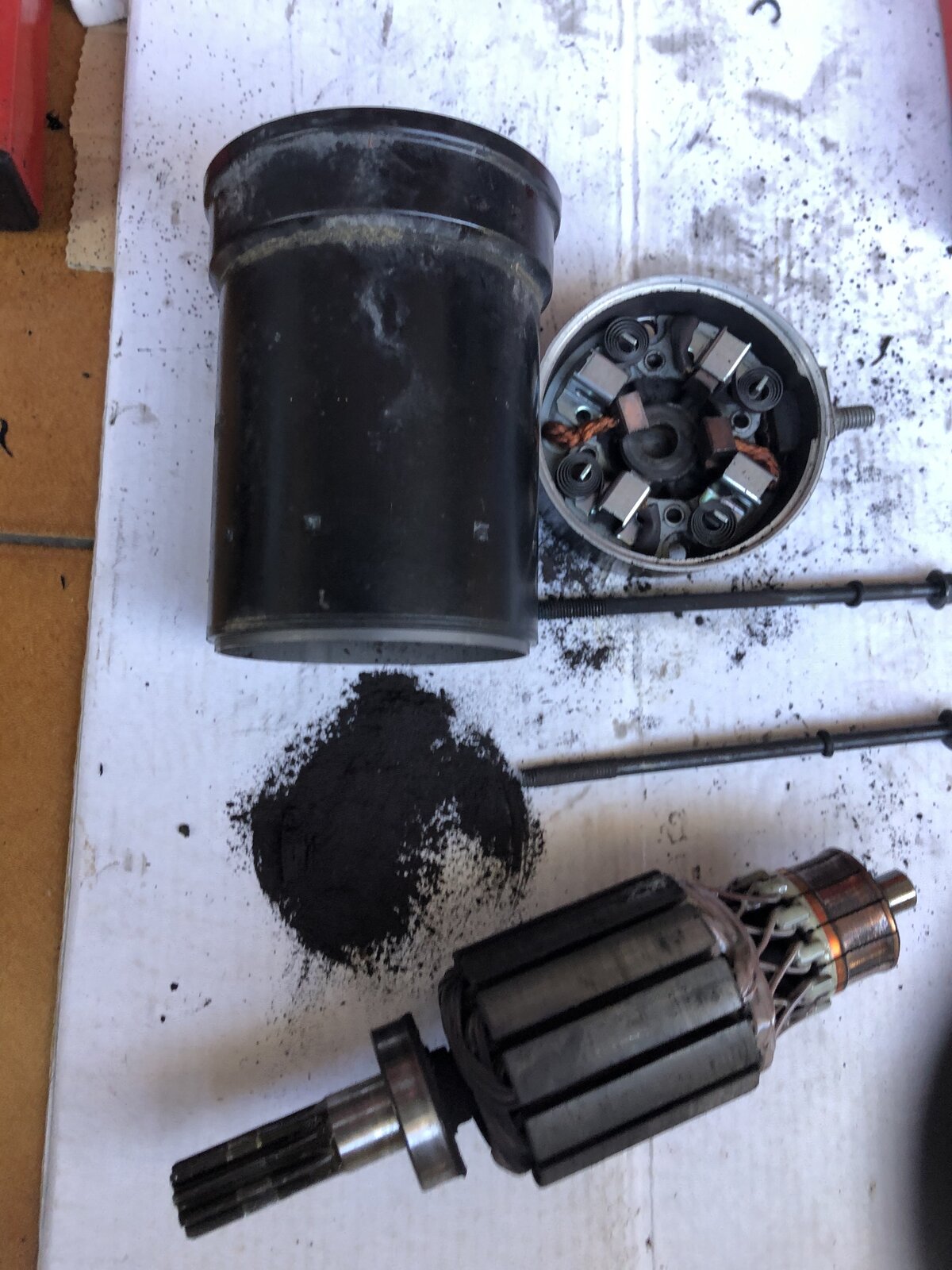

    I changed the super expensive starter motor with a new denso. Nothing.

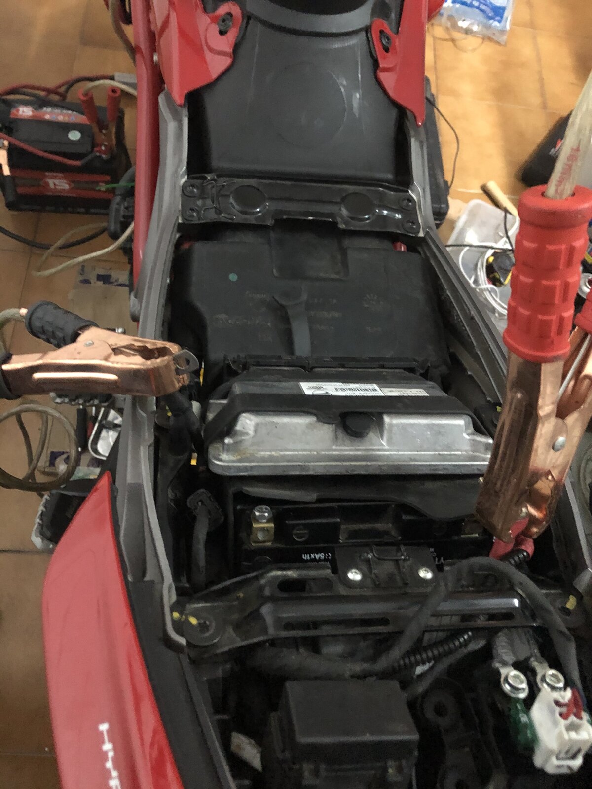

    Today I tried to start with a car battery connected...nothing. She doesnt cranck...i

    I am annoyed with this. I paid 465€ just for the starter motor... and I have ridden just 600kms since I bought it.

  6. How can it crank with the std battery and not with the car battery fitted? Have you done anything else to it?
    The car battery is definitely charged and connections are good?

    And this afternoon I tried to start with a big battery and nothing. I checked the battery first and gave 12.61v... enough to start up
