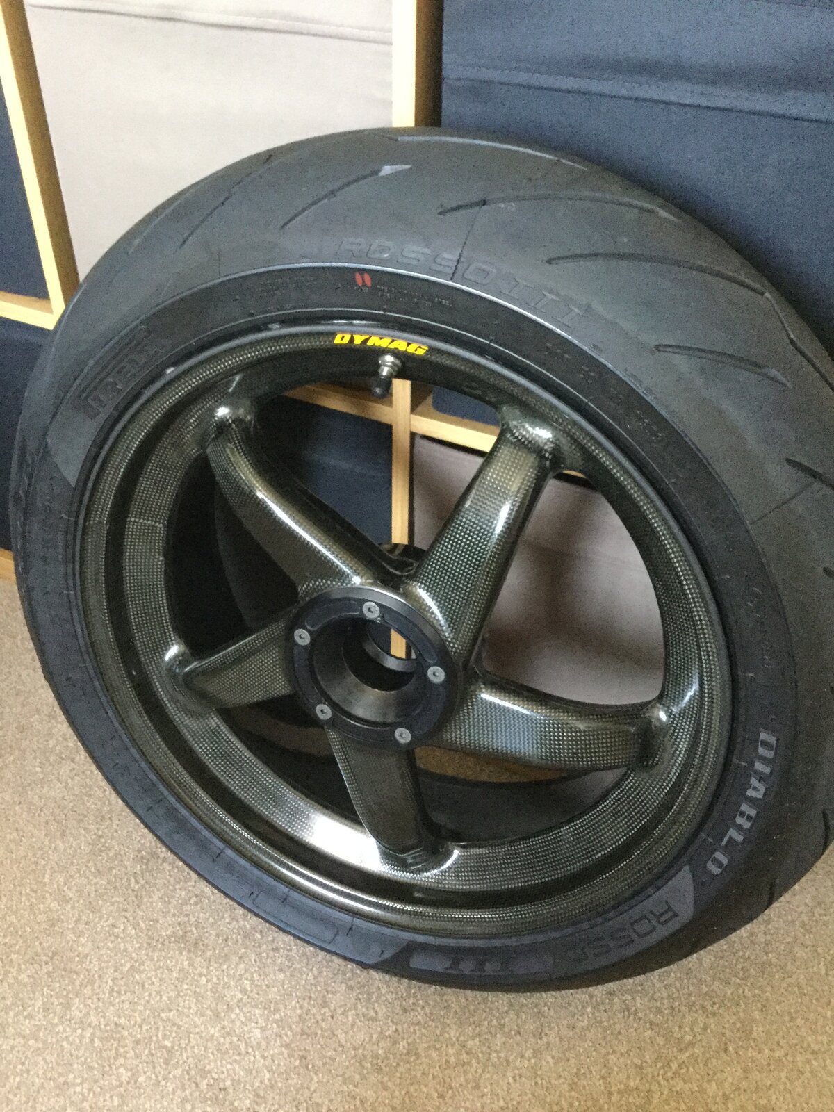

I have some brand new Rosso III’s on my Panigale wheels which I’m swapping to some Supercorsa’s (which I also have) Question is, would the 200 rear section be ok on the Multistrada? I think it’s been brought up before but I can’t find the thread.
