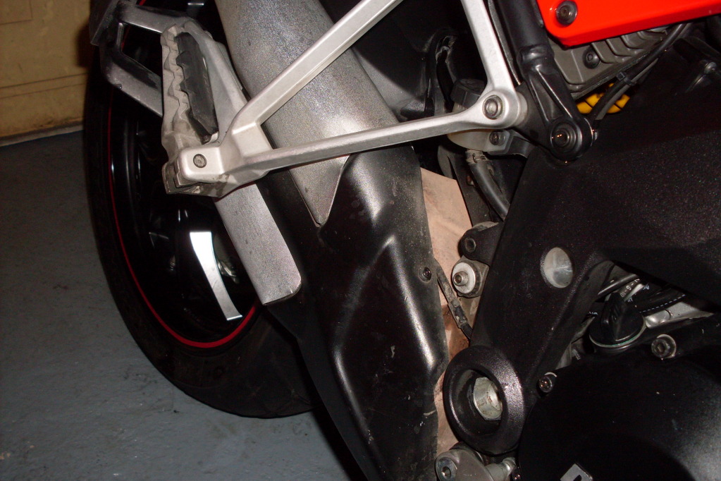

    Remove the cover between the exhausts. This is secured by three 3mm allen headed screws, two fairly obvious at the front top and bottom and one between the exhausts at the rear.
    This covers the valve mechanism which is attached to a cable.
    To check it you can take a firm grip of the top and turn it a quarter turn clockwise. Dont worry about the cable becoming loose it will re tighten when you release the valve cam.
