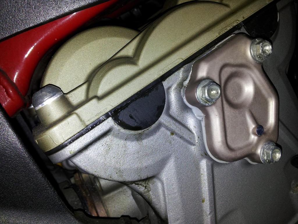

  3. Bike booked in with dealer. .it definitely has a lot more engine noise on the front cylinder but not from the rear..and the exhaust sounds like its blowing somewhere as well...
    Pic attached
  4. Was also going to add that the rocker cover casting has a few imperfection on it which you can see looks like.bits have chipped off
  5. If you're referring to the marks along the edge they look like they're from the casting process. It does look like its weeping though.
