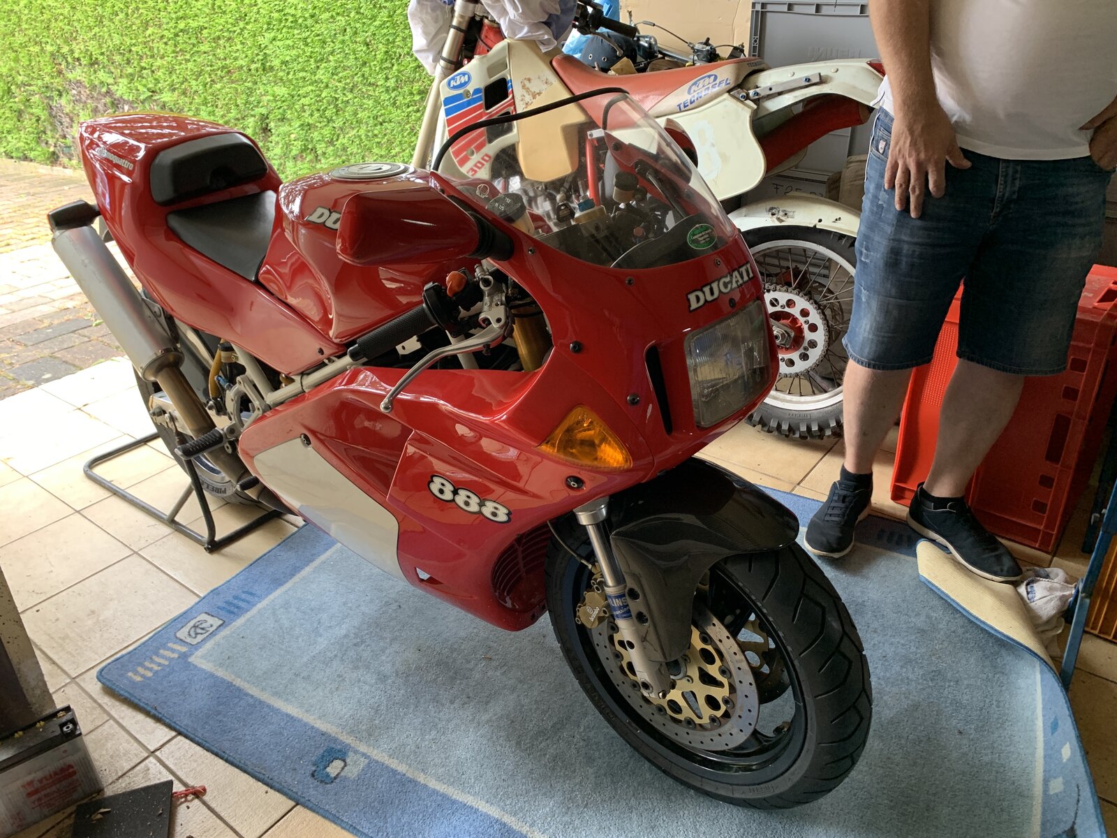

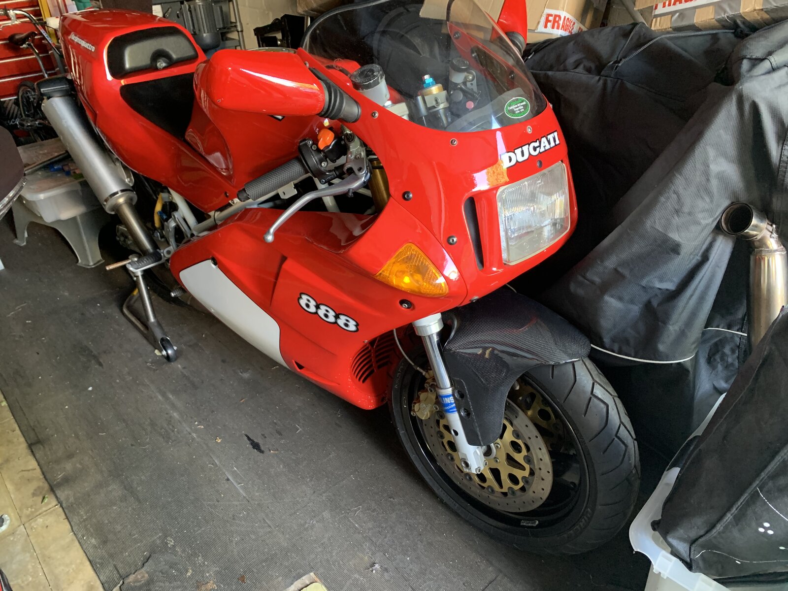

    So the story started 3 years ago, collecting a 888 SP4 from Germany.
    Bike looked in great condition and clearly a meticulous owner, though he rode the bike hard.
    One owner from new. All original but for a 999 brake master.
    Oh and the motor was 851 implemented as a temporary replacement due to cracking the cases.
    Came in the package a set of spare cases and the real engine in bits.
    And the bike had not run since 2004 - so full reconditioning on the cards!

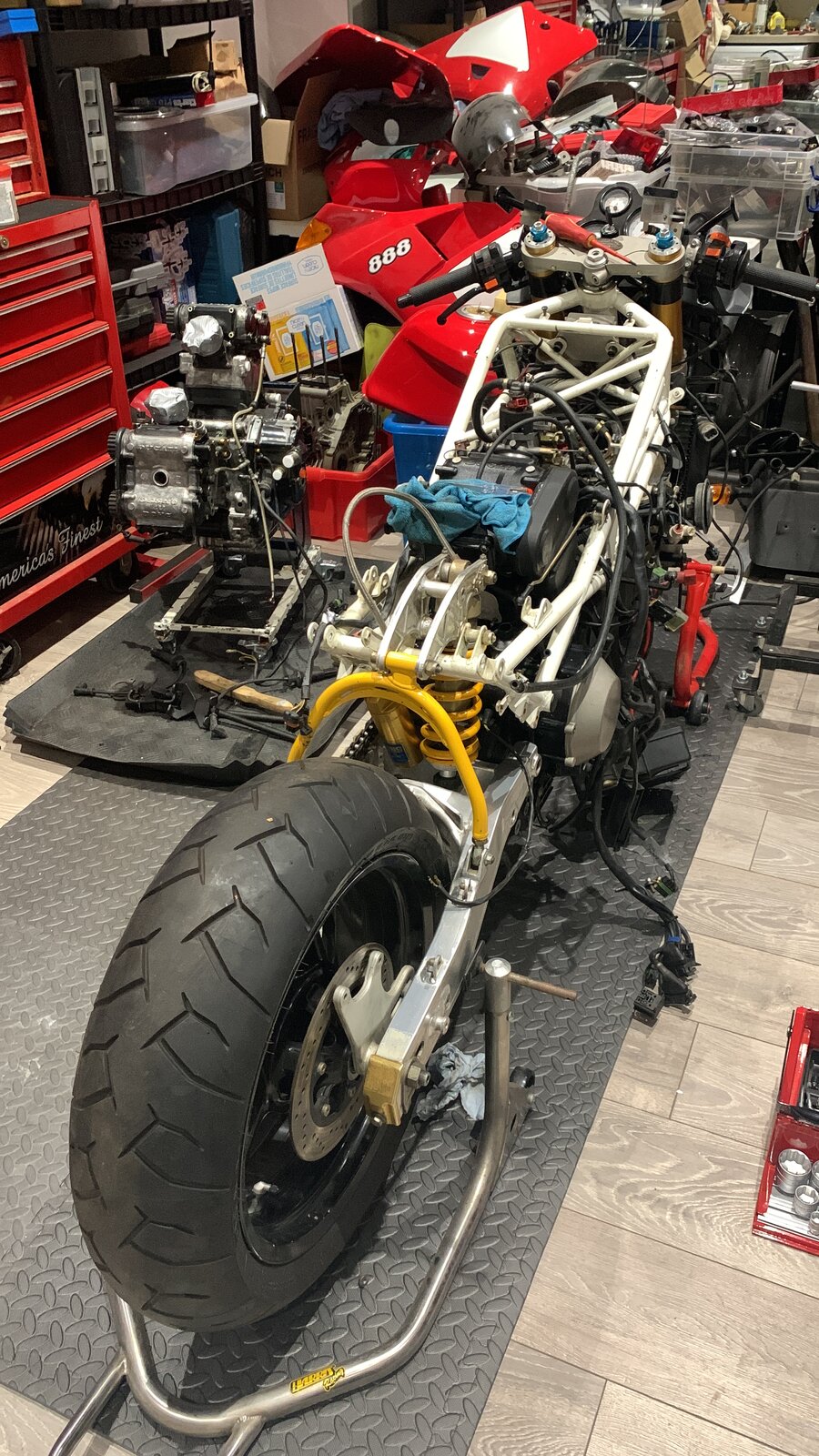

  2. Bike back in UK and then moving house...
  3. in 3 years I pretty much took the fairings off and that's about it.

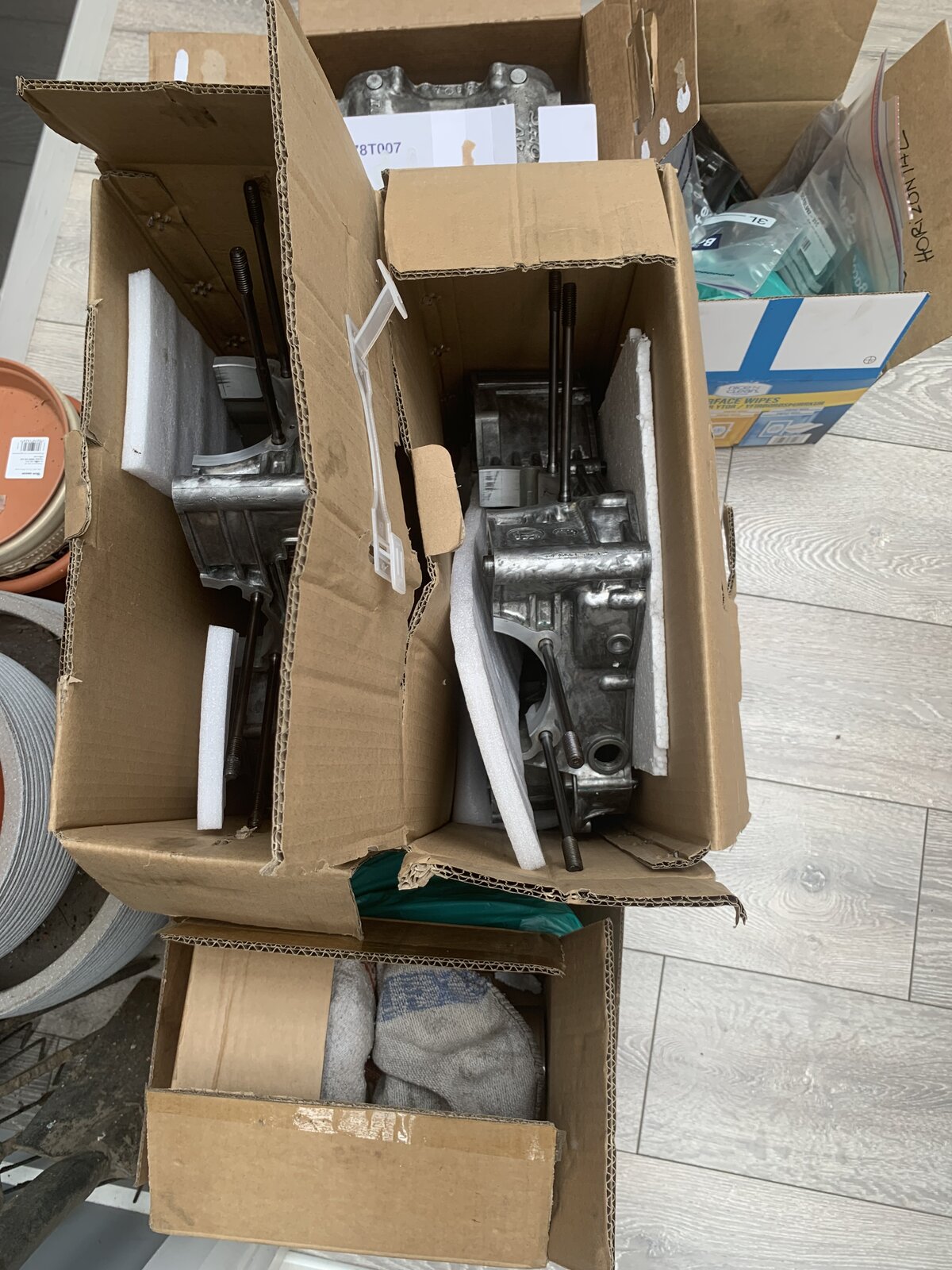

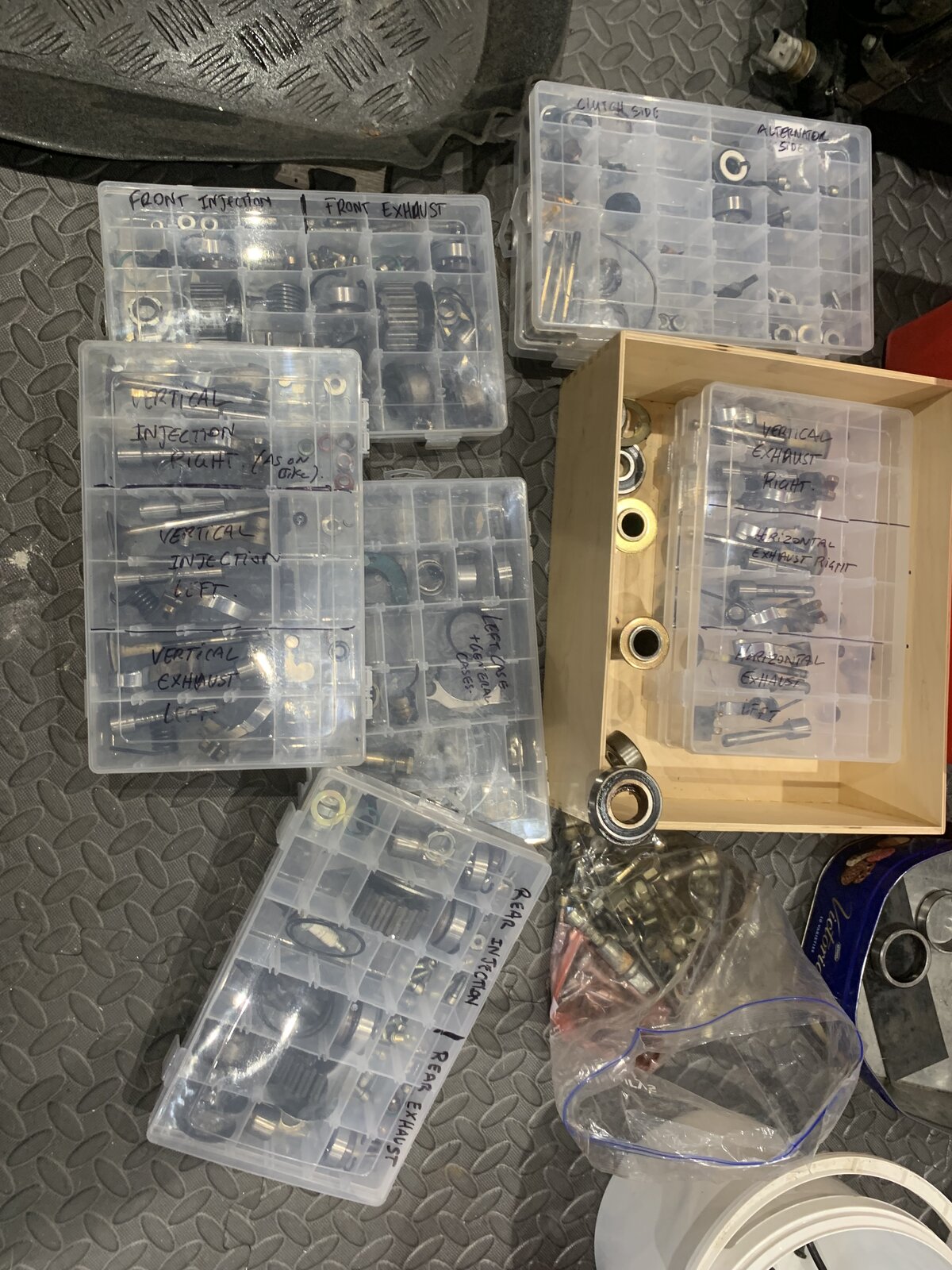

  4. Earlier this year, I decided to give it a go and it all started.
    My initial intention was to do a simple swap of engines and freshen up things without going too crazy, as it was a very clean bike.
    A bit of OCD later and decision is a for clean rebuild:

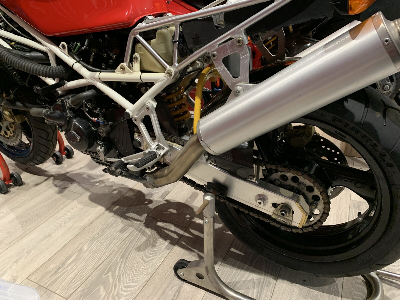

  5. Even on such a clean bike, you come across some surprises that make me glad to undertake a clean rebuild:

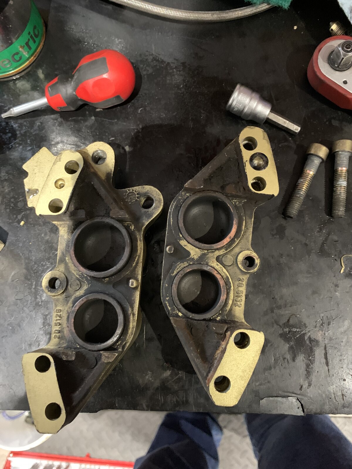

    - A brake piston was pretty stuck --> does not matter as all calipers and master/slave cylinders to be rebuilt fresh

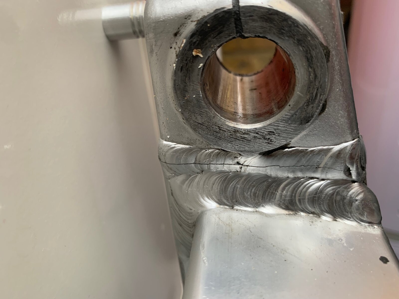

    - hairline crack on a weld of the swingarm --> No biggy - bringing it to ExactWeld for repair as I prefer to stick to repair the existing rather than change it.
    - Bent clip on --> Very small job for Motoliner in Kent!
    - Spare engine --> needs a refurb but really good inside. No worn rockers, clearances super tight, etc. So, full refresh on the cards

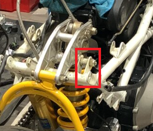

    Have you checked the bushes on your adjustable suspension rocker?

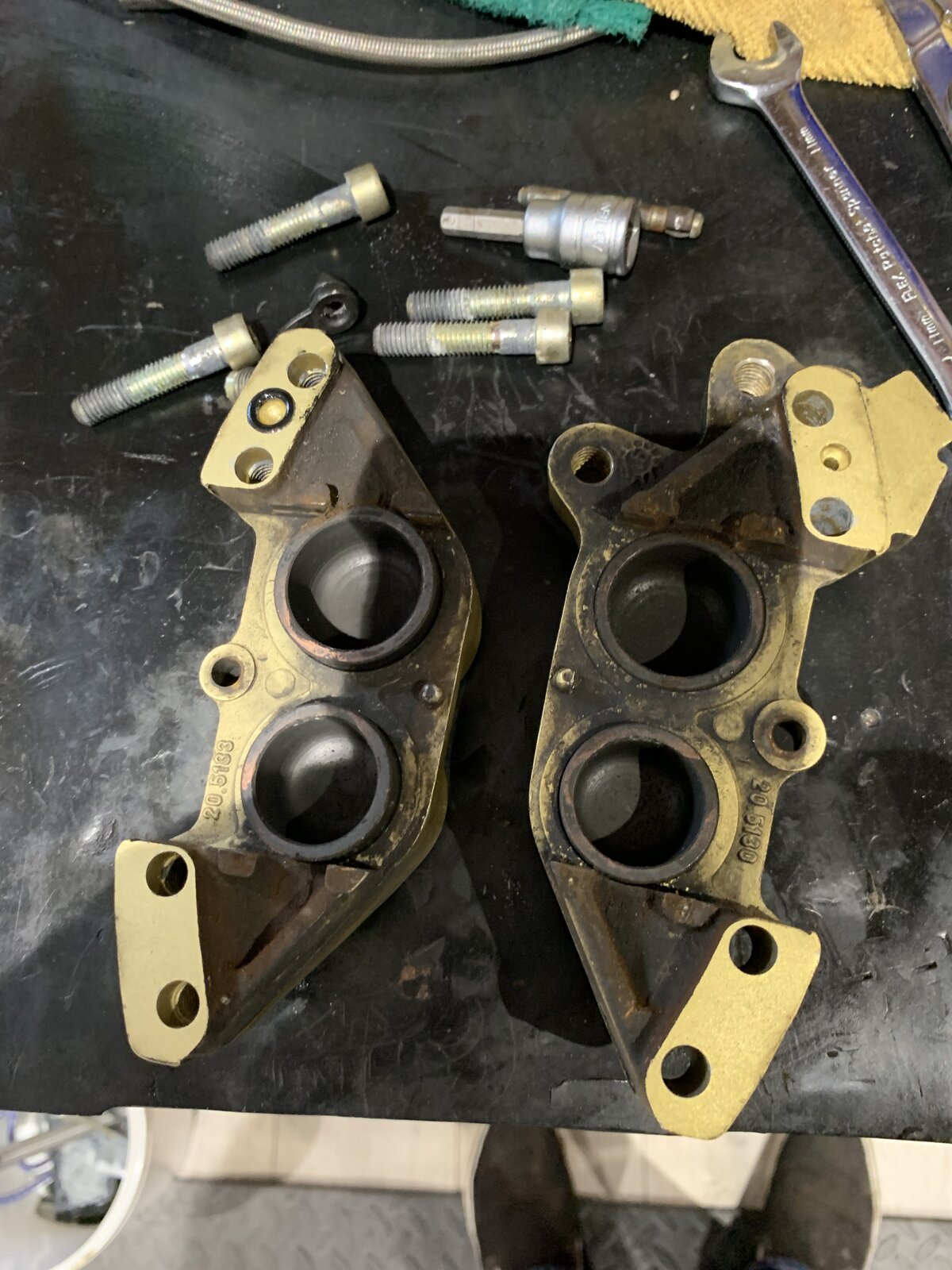

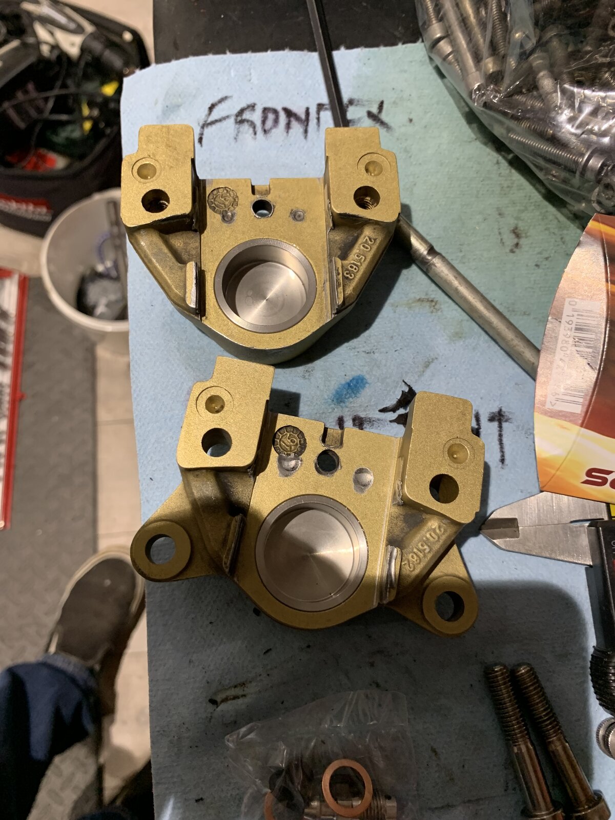

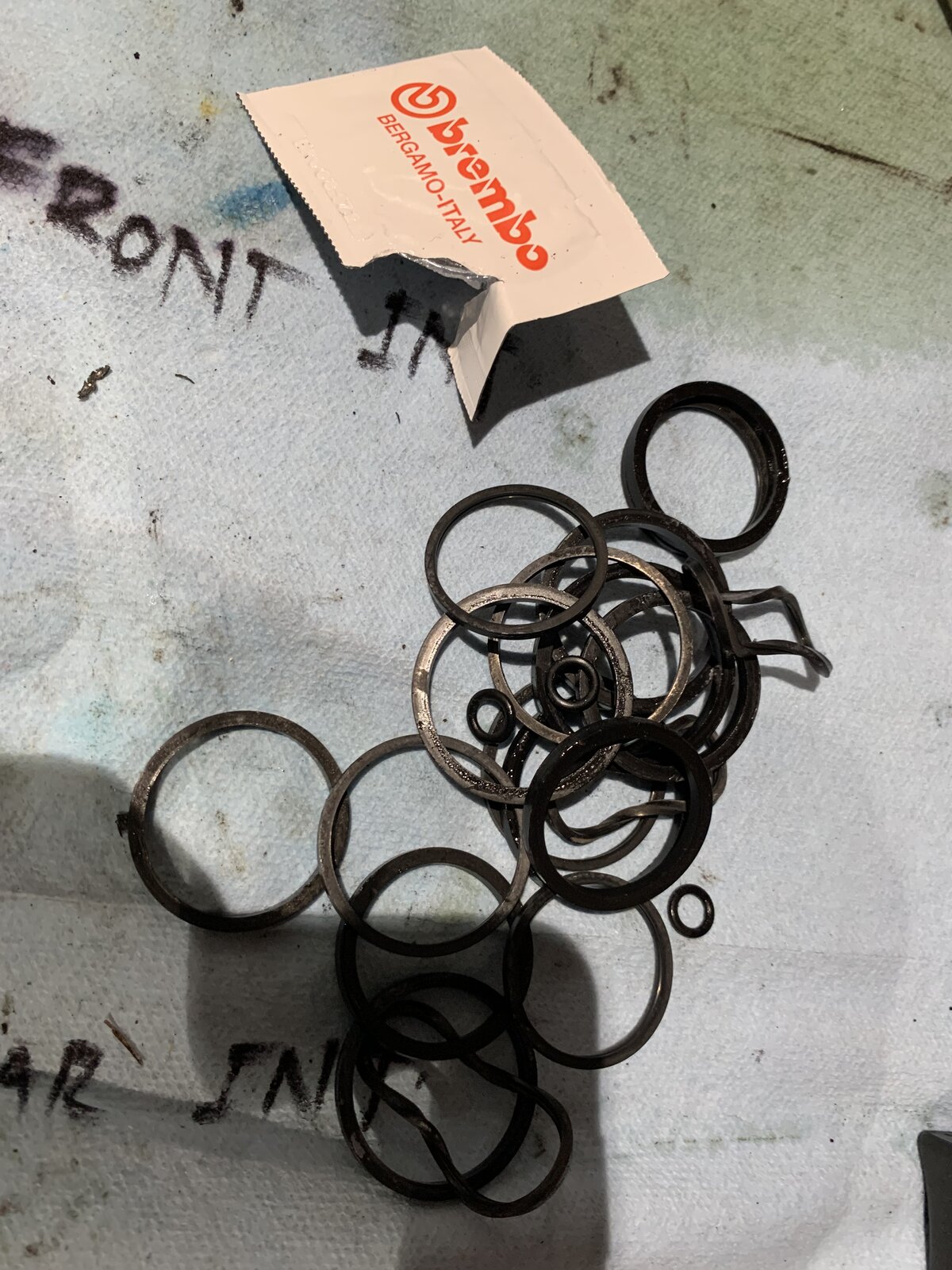

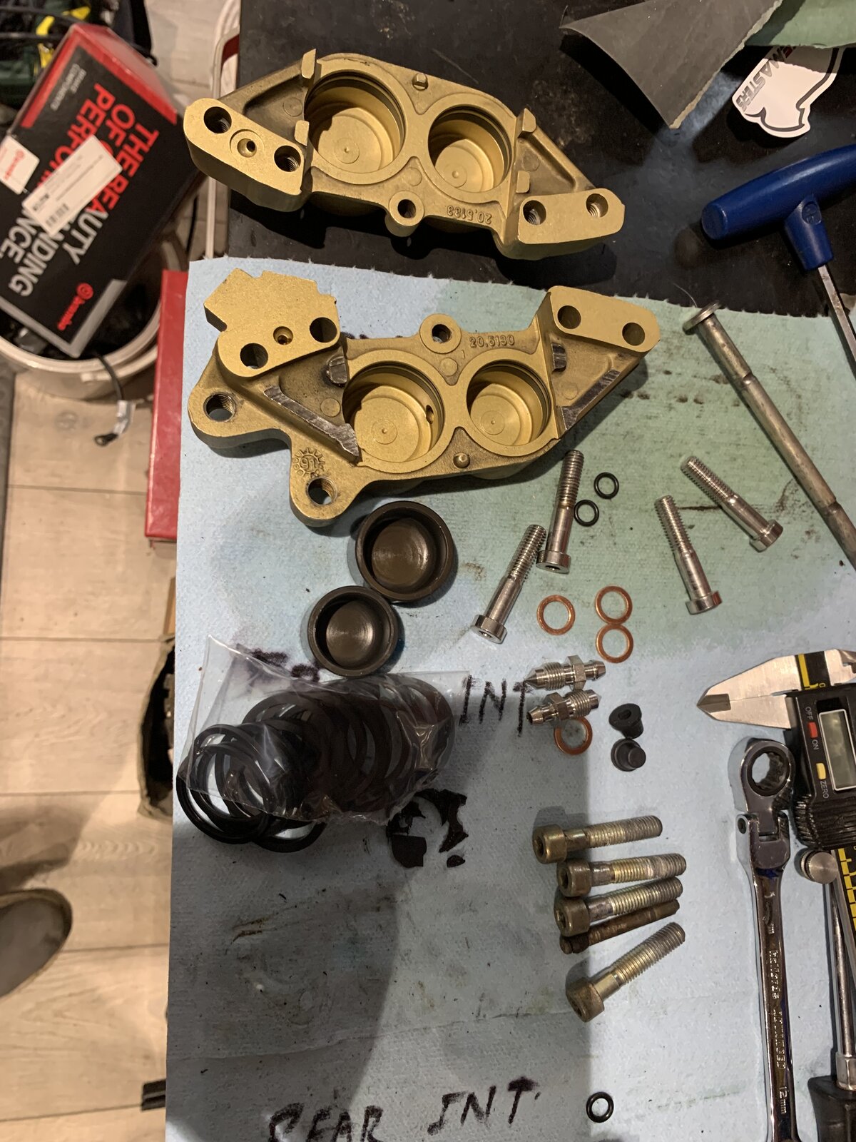

  7. New brakes!!!
    Cleaned up and all seals replaced
  8. I was actually thinking about doing just that.
    The hoop as well - I intend to get it refurbished so bearings will need to come out.
  9. Careful with those rod-end bearings on the hoop, and try to get them cleaned up and operating smoothly if you can. It's very difficult/near impossible to get replacements - the alternate is to to drill and helicoil the hoop to accept a different thread pitch on the bearing (but I can't recall off the top of my head what the alternate sizing is...)
    I've had two bikes that have cracked their bushes on the suspension adjuster rocker... which is why I ask..
  10. Thinking more about that suspension rocker - on at least one of those bikes that I had a problem with, I had found that the mount that I've highted in red was slightly bent towards the rocker (overtightening of the bolt?) - almost certainly causing the cracked bushing and making it very,very difficult to get the rocker out of the frame.
  11. Not a problem here. The bushing inside the pivot is all good though I may indeed look to change the needle bearings in there.

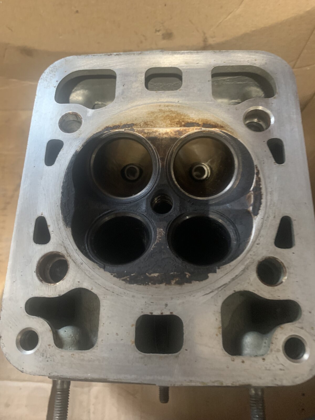

  12. Dirty head - Clean head...

  16. All packed and delivered to Hi-Spec coating for Cerakoting of all cases, heads and all the covers
  17. Everything in boxes.

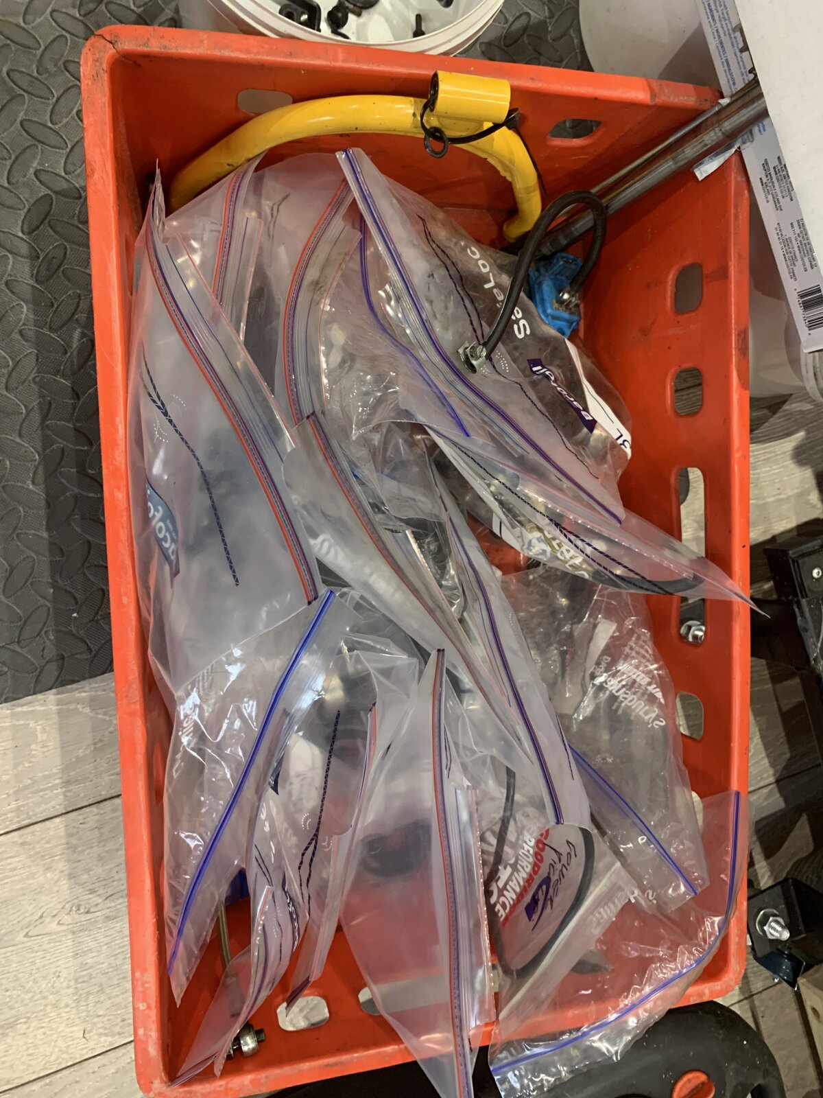

    Now going through to order all the new bearings, seals and clean up all bolts, and give a good scrub to the valves.

  19. Very well organised :)

    The swingarm has been rewelded all nicely by ExactWeld. Photos to follow too. However, the process means that some anodising has come off and I now need to rebrush the alloy / re-anodise. Anybody would come recommended in the Surrey area? I tried A1 coating but they never responded.

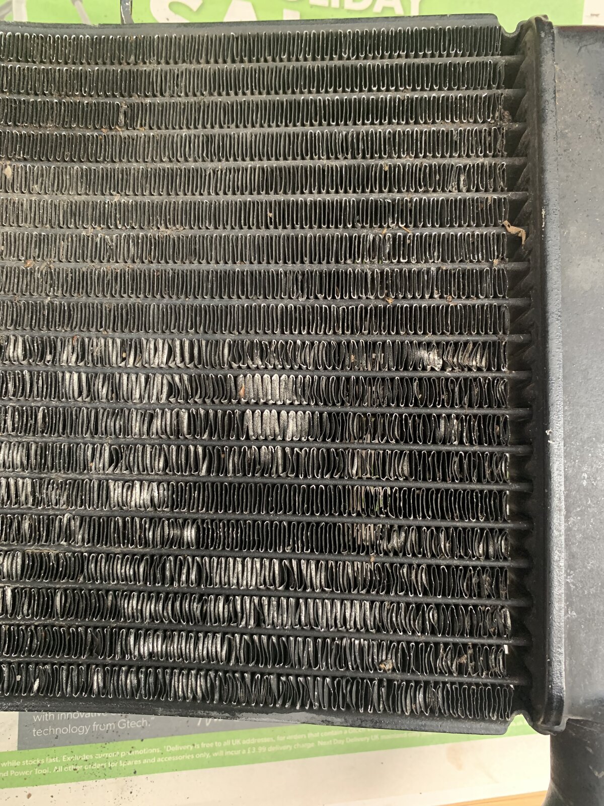

    In attachment, a work of love and patience. The fins of the rad are all quite bent and I am going through them one by one with some tweezers to straighten the lot. About half way there, but the work is looking pretty good. Once all straight and the dirt cleaned off, I think I will cerakote as well.
