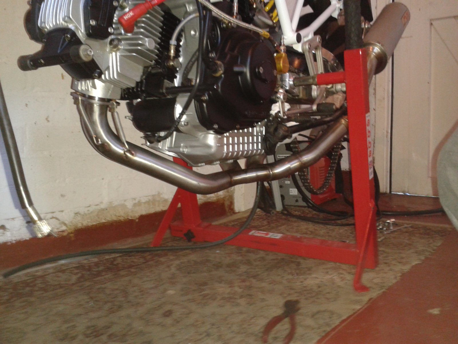

  8. I have the MADASL spaghetti headers on my Monster and whilst I've not got round to dyno time on them yet (must do soon) I'm fairly certain that there is an improvement but then they are also larger bore than the originals as well as being of more equal length.
    The engine definitely seems to 'breathe' better with them, particularly out of the left pipe as before the flow was very much biased out of the right side can.
    I will hazard a guess that I may have a decent gain because I'm certain that the old system was strangling the flow?
    Edited to add the obligatory pic;
