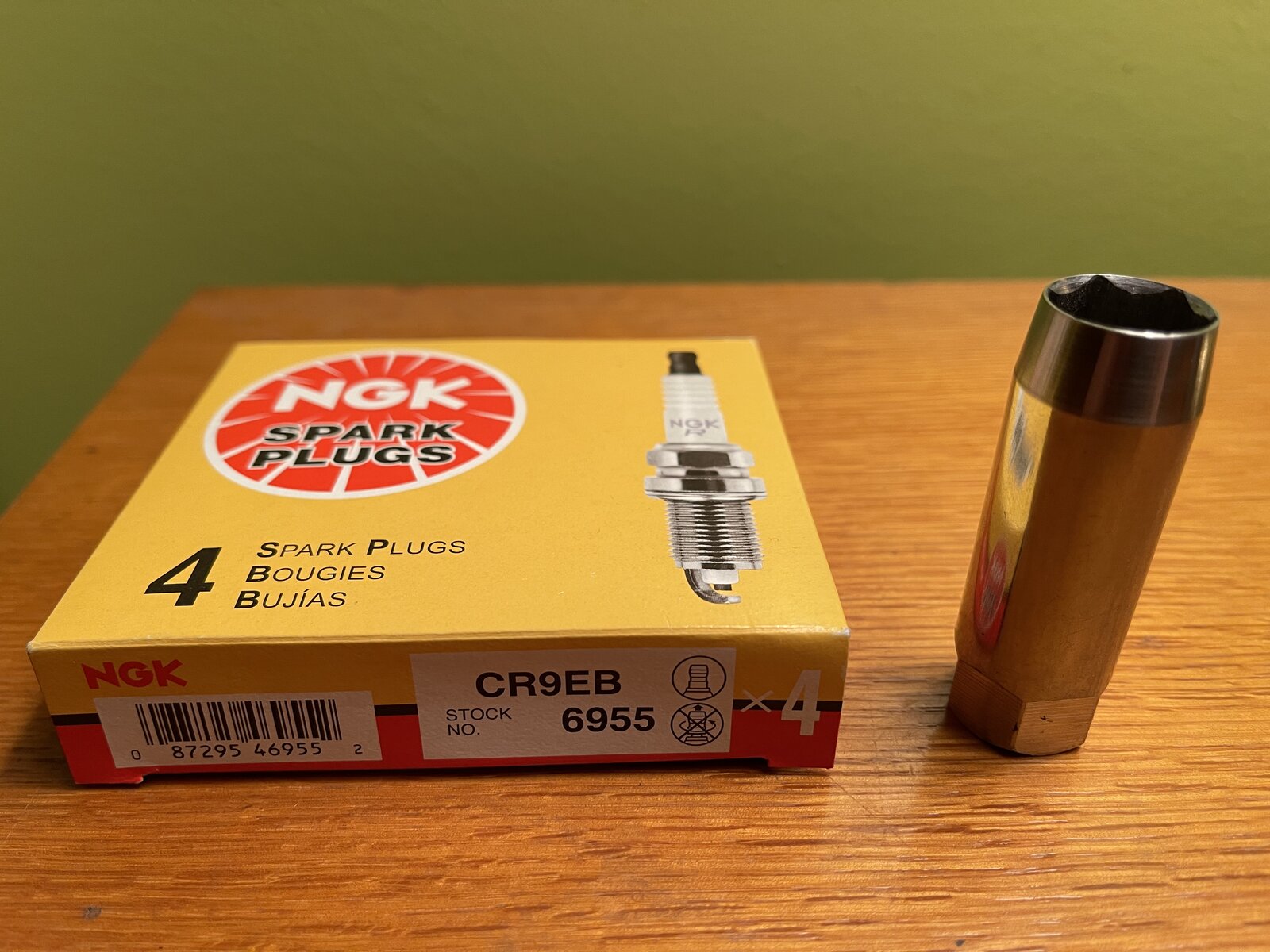

  6. I just fitted the NGK plugs but haven’t run it yet. Coil sticks seemed to “click” onto the plugs just fine. If the Champion plugs weren’t many times the price of the NGK (or if NGK wasn’t a proven brand) I would have gone with the Champion plugs. I tapered a 16mm deep well socket in a drill press with a file and this worked quite well with the NGKs.

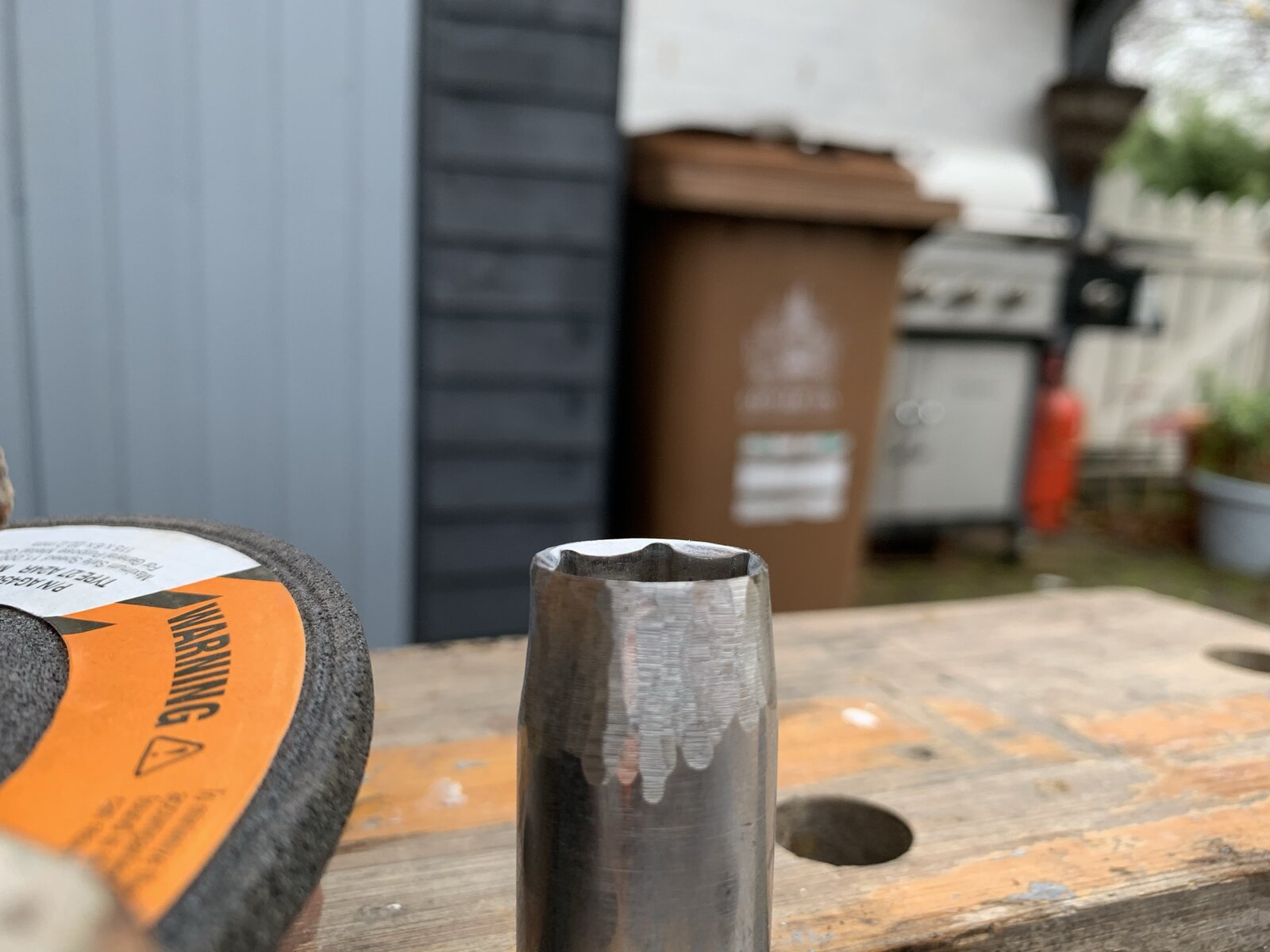

  11. You did a way better job than me
  12. That looks like it will work just fine.
    I had plenty of ‘rona time to work on my version .
