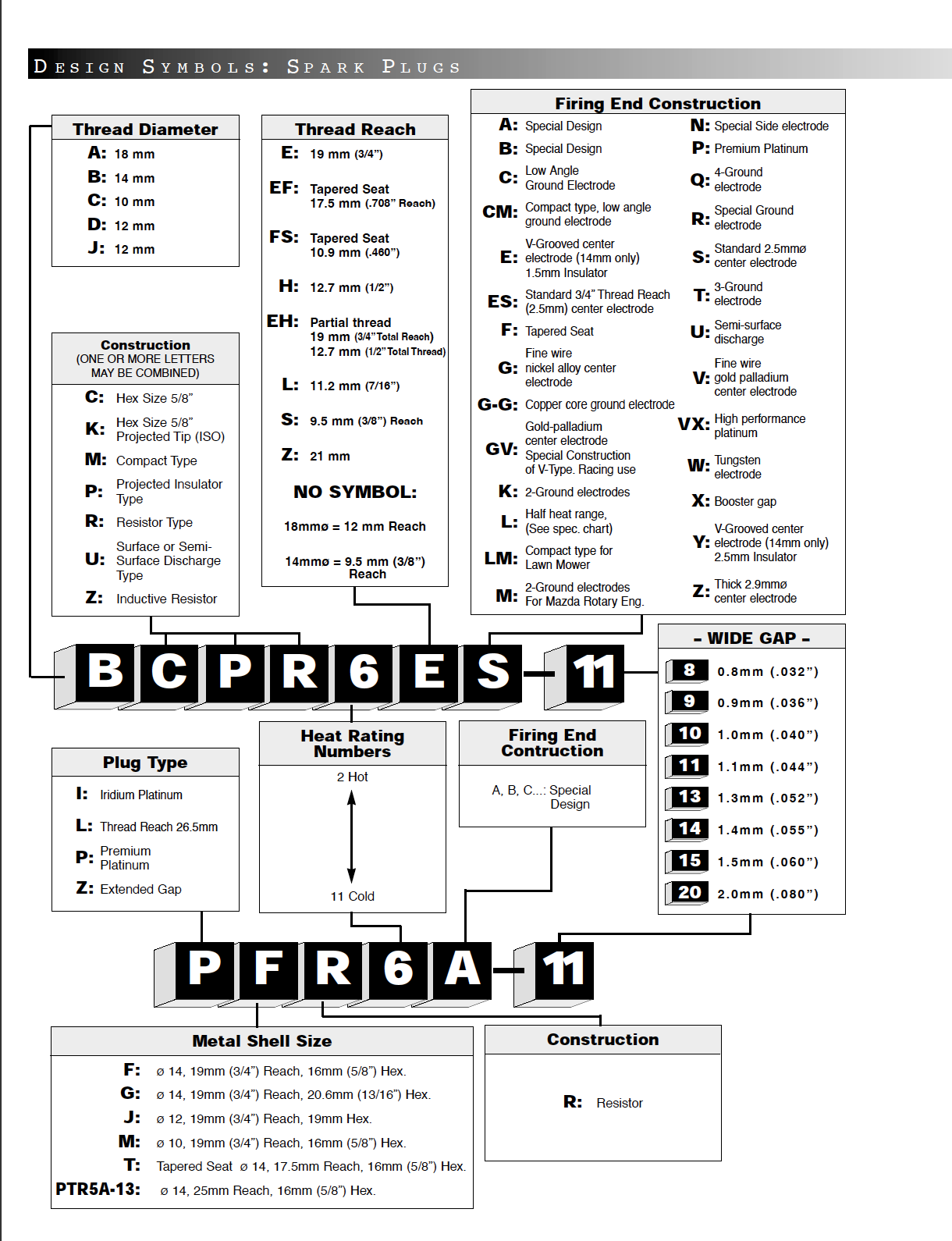

    This a chart showing what the NGK numbering means.
