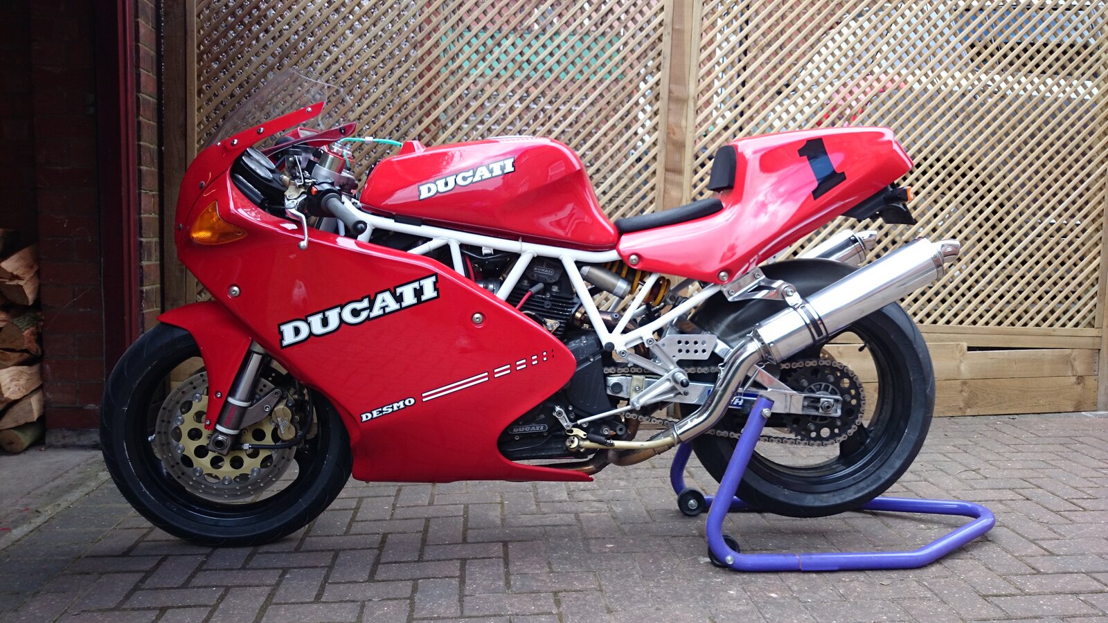

    Why is my 1993 900SS destroying the vertical cylinder spark plugs?
    As previously documented I changed the plugs, about 40 miles ago. Since then I've had to change to the spark plug in the vertical cylinder twice!
    For the last year, when i have had the opportunity to ride it, the bike has been a bit lumpy up to about 1/2 throttle. This prompted me to change the plugs and clean the carbs.
    I know I need to give the keihin carbs a proper service. I'm pretty sure at the very least the float valves need replacing and probably the emulsion tubes.
    But that said it wouldn't be the fueling causing the spark plug to fail. Would it?

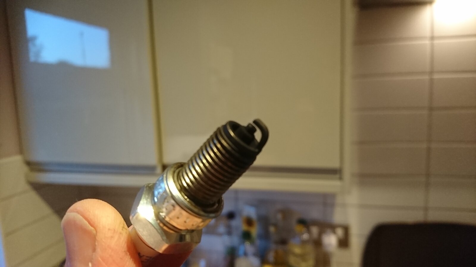

  6. So after a bit of Internet searching, I've found a possible issue! Ca cycleworks suggest using ngk DR9EA for their up graded coils. These two failed plugs are ngk DPR8EA9.
  7. From the photo it looks like a fuelling not spark plug issue, bike running rich and causing dry fouling.
  8. Could you rotate the spark plug so we can see less of the business end, soften the foreground focus and increase the depth of field.
    Increase the background lighting and make more of a shadow... perhaps shake the plug during the shot.

  12. This is what I would do to begin with, remove both plugs from the bike, clean the soot from the plug you have pictured , check the gap, place the cleaned plug in the HT cap for the vertical cylinder and hold it against the cylinder, ensuring the the threads of the plug are contacting a fin on the cylinder (not too close to the spark plug hole), don’t touch the metal part of the plug with your fingers, hold the HT cap, get someone to press the starter button whilst you look for a spark, then take the other plug , put it in the vert cylinder HT cap and repeat this process, any difference in the results?;
    Sooted/cleaned plug doesn’t spark but the other plug does, replace failed plug with a new one, turn mixture screw in on vert cylinder carb til it seats and then turn out 2.5 turns, go for a ride, see if it happens again.
    No difference in sparks- refit both plugs, turn the mixture screw on the vert cylinder carb until it seats, then turn it out 2.5 turns, go for a ride, see if it happens again.
    If it rides OK take the plugs out, your looking for them to be dark grey/black on the circular face and for the electrode to be light tan or light grey (not white!).

    Looking at the picture of the plug you have posted it is definately running on the rich side as it is not the "light brown" colour of a good mixture.
    What plug gaps are you using ?
    As an "aside", my '94 750SS runs DPR9EA-9 plugs with the CCW coils. I'm sure the -9 relates to a larger than "normal" plug gap, in my case 0.9mm I think it is, (but could be wrong).

    The duff spark plugs wouldn't produce a spark on either lead. Lovely blue flash on the horizontal plug on either lead. Not sure of the plug gap, but equal on both plugs.
    The bike has run a bit rich for thousands of miles. It's all part of the fcr fun.
