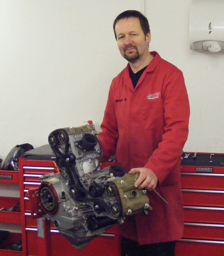

  1. this is a special engine built by Jeff Green of GTEC and other renowned history. I have a full picture history of the build by Jeff, this was done in 2012.
    It is an F02 sand cast crank cased 104mm bore (999R/1098) with a lightened, knife edged, balanced 1098 crank, 749R titanium rods, and HC F06 pistons. The heads were modified by CJS but keeps the std valves and cams. This give a CC of 1099.

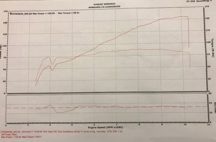

    It has 155 rwhp and nearly 90ft llbs of torque. The dyno chart was done last week by Iain Rhodes and shows it is still as strong as it ever was. These dyno rear wheel power figures are very comparable with a std 1198!
    I currently run it on a microtec ecu and have the map available by file.
    There is no clutch with it though i might include the carbon belt guards at the right price.
    Given there are standard 999 engines on eBay around 1500 quid id like offers around £2000 or your constructive thoughts.

  9. the meticulous build also showing the crank modifications
    As the crank cases are F0 sand cast they did not have a neutral light or starter machined in them although the casting was there for them. They were machined by jeff so it now has a neutral light and starter.

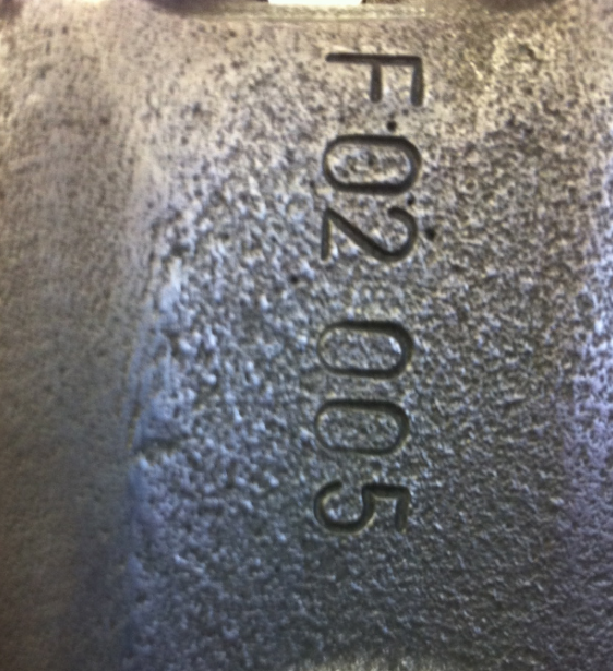

    Are the cases stamped with an engine number or blank ?
    Thanks

  18. No engine number in the usual area.. blank.
    however,
    its stamped F02 005
