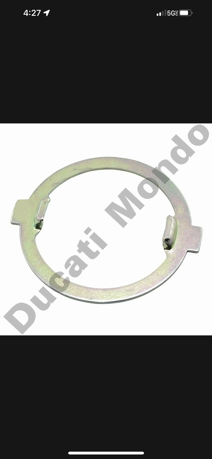

My speedo drive is not engaging on the wheel. I have the speedo drive and it is in good condition but it's still not working. I see some pictures online of a drive plate and seal as well but do not see it on the parts diagram. Can anyone verify if I need these? Thanks!

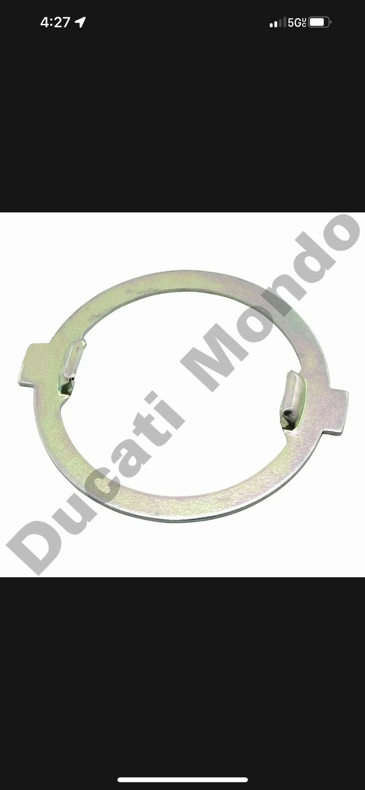

The cable and drive itself are fine. When I spin the ring in the drive, the cable spins fine. What I am asking is if I need the following which is not on the parts diagram :

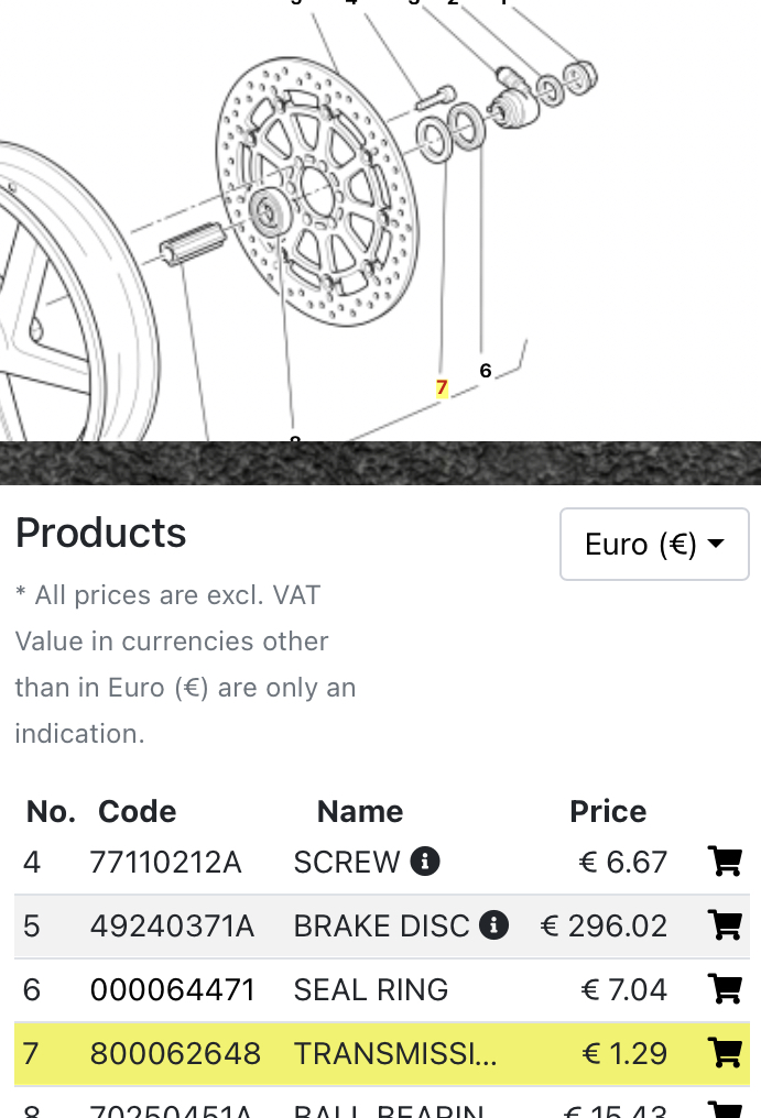

That part should definitely be on the left side of your front wheel for your speedo to work (Part numbers #6 & #7 on the diagram, I believe). https://shop.oemducati.com/en/products/superbike/2002-1/supersport-998r/front-and-rear-wheels-25
Thanks! That’s what I needed. The picture and description don’t real show/describe what they are. Got them on order now .

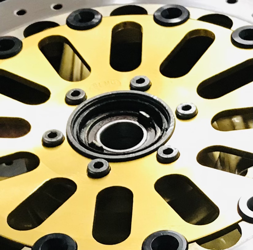

Make sure that speedo ring in the wheel is not bent. The tangs on mine were bent a bit and so no speedo reading. THey bent back and now it works find. Some care needs to be taken with this stuff when reinstalling the front wheel
