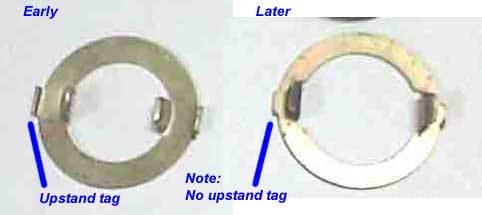

  11. If you get stuck for a complete drive unit, I can lend you one until you get the right one......1996 model should be the larger axle.
    Check your wheel to be certain........the brake disc locating ring cast into the hub should be approx 4mm thick.......the earlier wheel for the smaller axle will have a locating ring approx 6mm thick.
    You can actually tell by looking at the drive plates as well....see below.
    I assume you didn't bugger the grease seal.
