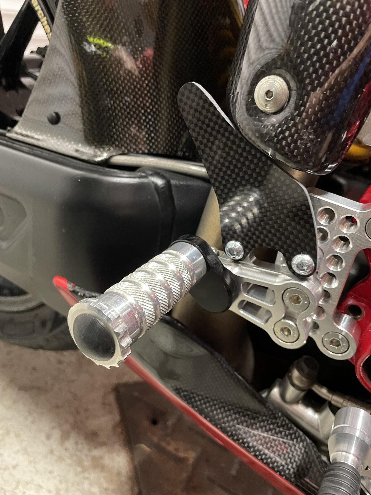

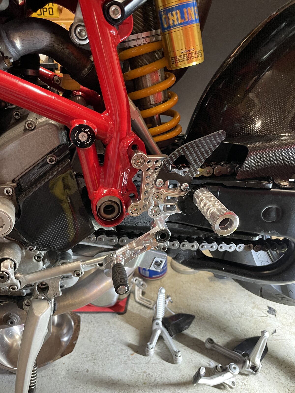

  1. I have just fitted a pair of these to my 749r. They apparently can be used in both road and race shift but I can’t see how they can be switched to race shift. I know it is as simple as fitting a reverse shift lever direct to the output shaft but no lever was supplied other than the one in the picture. Anyone got any idea? I’m happy with it in road shift but curious and can’t be arsed taking the gear shift off again to see it has a clever method of reversing.
  2. Just flip the short lever 180° on the gearbox selector shaft ;)
  3. I would need to get a new one as the clearance is so tight if turned 180 degrees. They are available but the rearsets are advertised as both road and race shift so I just wanted to make sure I’m not missing a thing.

  5. 1 up 5 down.

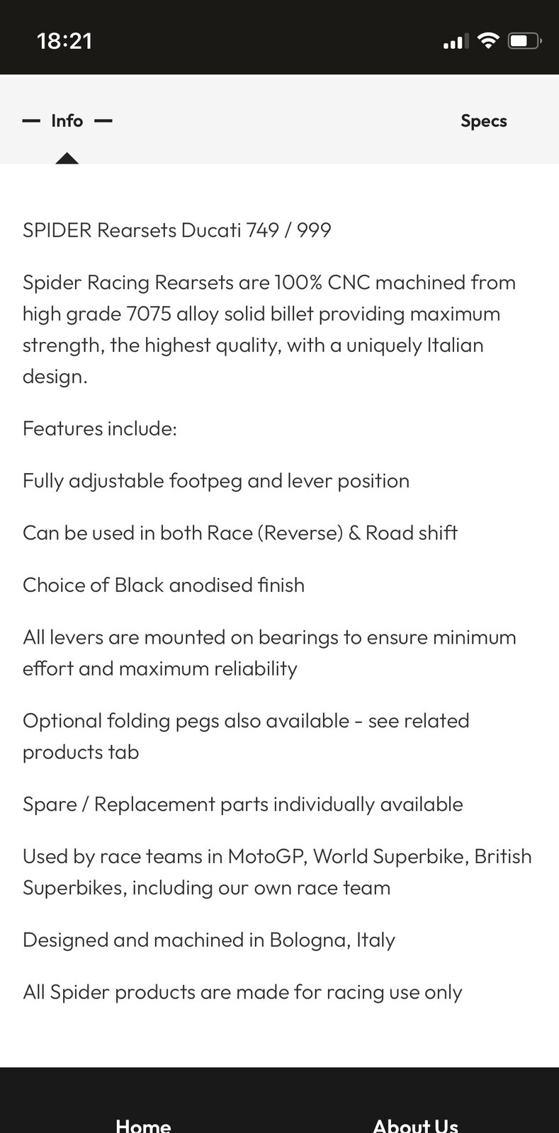

  6. Where is the advert ? Spider’s website shop makes no mention of road/race shift pattern that I can see. Andy

  8. Depends which uk supplier you look at. I got my supplier to check with Spider before ordering and they confirmed both race and road shift.

  10. I’m not so sure the information you are getting is accurate. Tried to compare the pictures of my Panigale V4 rear sets with the 749/999 pictures and I can’t see how the 749/999 can work in both configurations. Andy
  11. I agree, it can’t. Without modification.

  14. You need a direct lever, I have a Ducabike for 50 euro, remove the Spider lever and linkage.
  15. Just cut some heel plates for them as the rhs fouled the exhaust heat shield and the fibre was twill matt. Obviously these only work on the peg position I have got set on the rhs which equates roughly to the standard upper position.
    Thanks for all the replies. I know I can buy a reverse shift lever and the eBay pivot would probably work. I’m happy running road shift but I hope this thread helps others buying these rearsets. Nice but need fettling.
