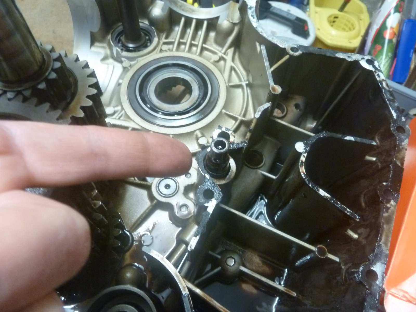

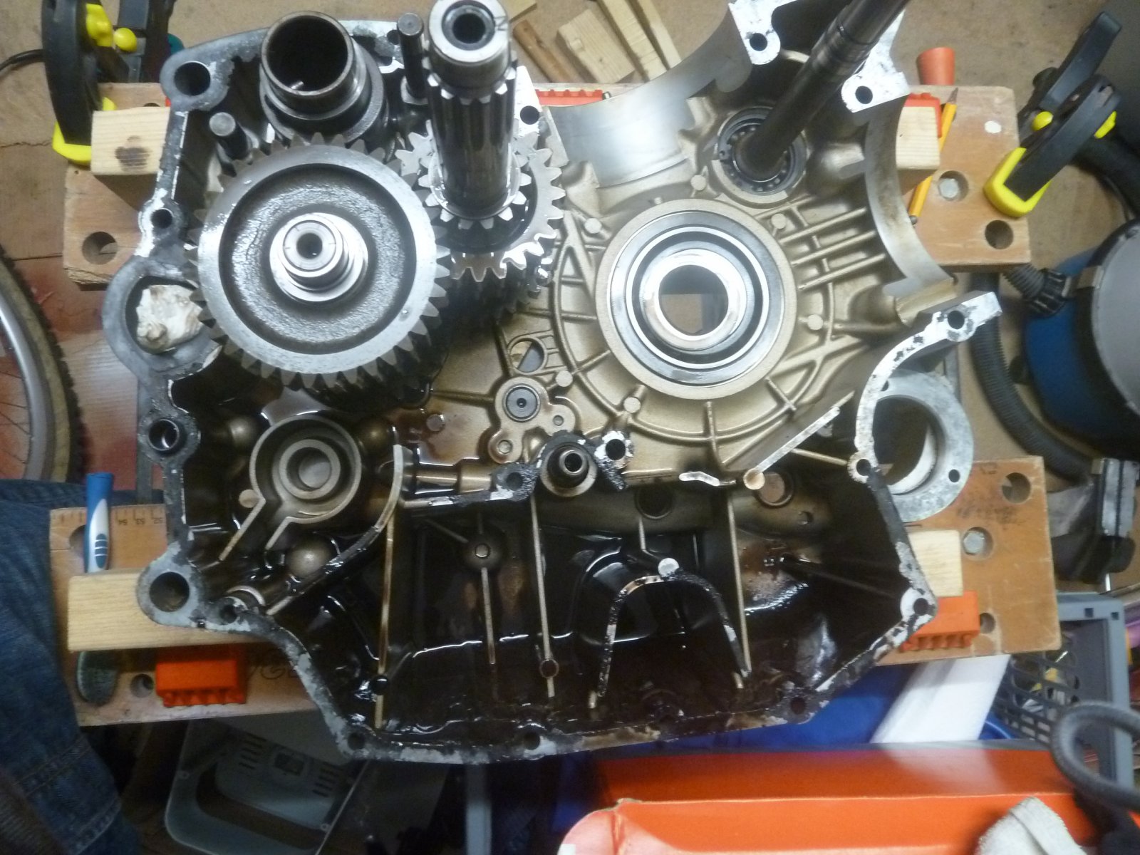

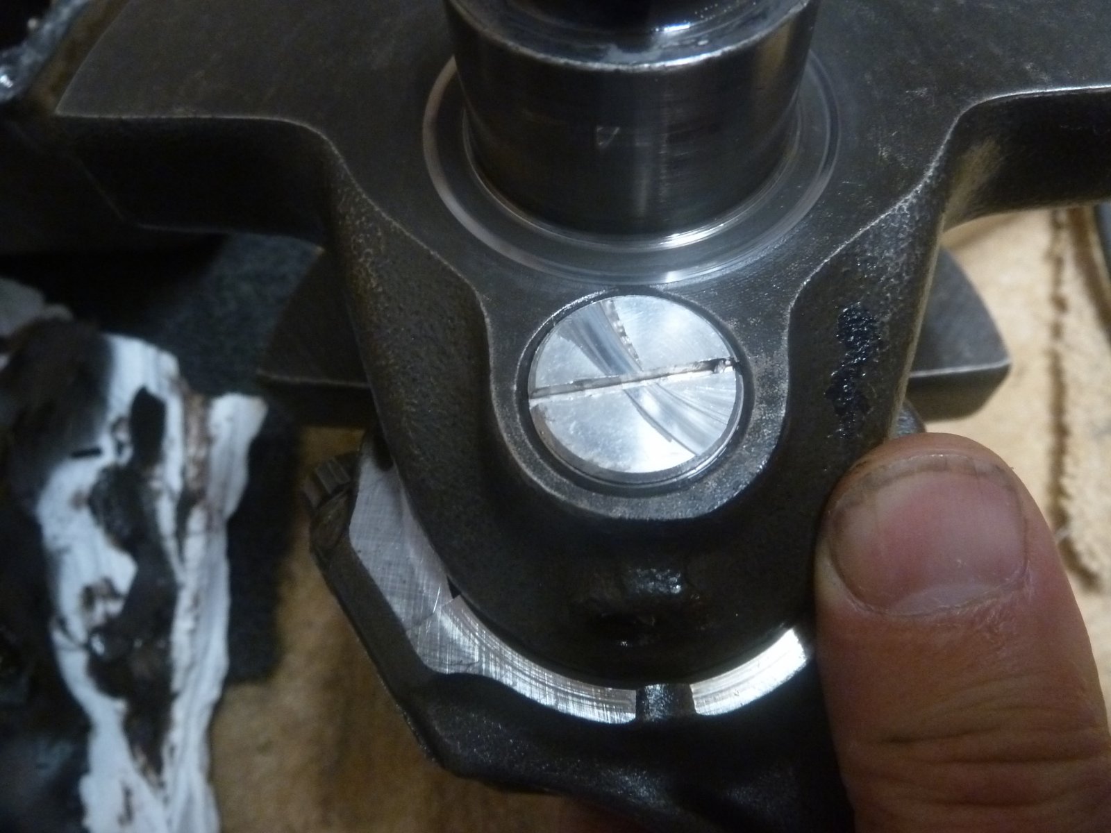

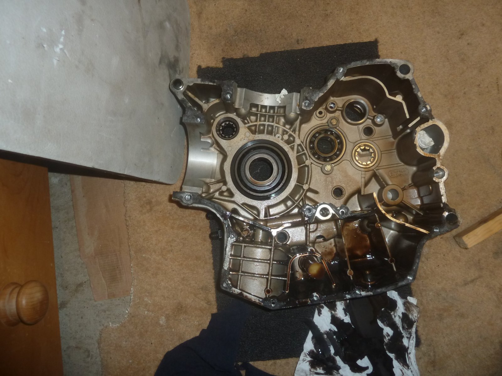

    Photos as promised.
    The bit Iam pointing to is spring loaded, can anyone tell me what it is and was the spring holding anything in that may have fell out
    The dreaded plug.
    Top left of picture you can see the marks the gear made in my foam mat 1.5m away.
    I was not going to change any bearings but turning the pulley drive shaft (pic 2 top right) it seems a bit notchy so that might have to be an exception.
