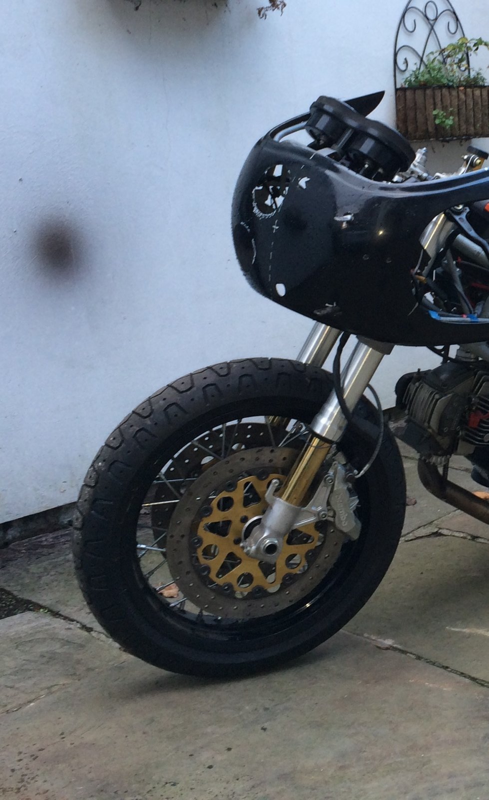

  7. I think the Sport Classics that have spoked wheels use fixed inner pad calipers to keep the caliper slim wheel side to clear the spokes. You might need to change yours.

  11. I have used a pair of Sport Classic wheels on my 900ss special with 999 forks. I managed to use the 999 calipers by having the backs shaved so they'd clear the spokes. Not a big job at all. Ombra Nera front end.jpg
