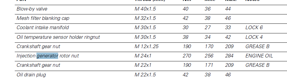

    I'm guessing this is the torque i need..256nm min 284nm max 270nm rec
  5. Yep that's the one I used. (270)
