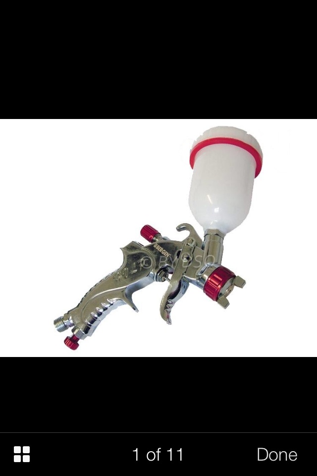

  3. Dear Red..
    Thank you for your advice..
    I have a 2.5 hp compressor which I normally set at 60 psi for spraying with my mini gun..
    This is a Bergen as per picture..
    The paint is already mixed from movac, and they recommend a 50/50 mix with thinners..
    I mix the paint thoroughly with a small automatic mixing device I have, then filter it at least 4 times via micro paper filters..
    I do have a bigger gun with a 1. 3 mm nozzle which I've yet to use... It's a non gravity fed gun... If I get the paint correct I then use a 2 pack lacquer with separate hardener..
    The pic below is the Bergen 0.8 which I have been using..
  4. Spraying as you know\have found out is very subjective. What works for some won't work for others because of many factors including technique, temperature, type of paint and the list goes on.
    If you are using a 1.3mm syphon gun then that should be big enough as the 1.1mm gun I use can spray quite large areas for its size. It's supposed to be used for door jams and other small areas and I use it for painting numberboards, so if you are spraying casings with it then it should be up to the job.
    You pressure seems high, I use about 50 psi constant at the gun but you should go with the manufacturers recommendation and if that is too low then up it about 5 psi and see if it improves. Don't set the gun to 60psi and then use it because it will operate at a much lower pressure, I assume you know this?
    A 2.5hp compressor is a little small but it depends on what it is. I use a 3hp twin cylinder two stage compressor with a 50 litre tank and that is good enough using a 1.8mm tipped syphon gun to spray a car. If your's is just a 2.5hp single cylinder single stage then it might be on the small side. Are you get a big pressure drop or is your pressure switch set too low on the tank pressure side. It shouldn't be but I have found my 2hp compressor which is single cylinder and single stage is firstly not good enough to try and spray anything decent with it and also the pressure fluctuation is a little too great, this is down to a sliding pressure drop at the gun, a common problem, you might start of at say 60psi which gives a good pattern only to see pressure drop or fluctuation that stops the gun performing as it should. This would then also be a free air delivery problem. My little compressor is fine for blowing up tyres and small air tools etc. but not good enough to provide a decent spray job.
    It sounds like you are using metallic cellulose or a non two pack acrylic type paint, I assume it's not water based which is very different to spray.
    It's obviously not two or three pack, which is fine and in which case have you tried using more thinners to wet out the paint more. I use two pack for Ducati colours and it also requires a ratio of 10% thinners but I always go for more and range it up to about 20% to 25%.
    If you are using quick flashing paint in this weather, like yesterday (very warm) then your paint is going to flash so quickly it's not going to settle.
    If you have what I term a bird seed finish you need the paint to be wetter and not too quick to flash, it needs to flow but not be so wet as to dry slowly enough to run.
    On the face of it you are being very meticulous but probably just not picking up on one small element.
    I have been spraying, not professionally, for many years and I know how difficult it can be to get the right finish and the time it takes to get things totally spot on.
    I hope the above general advice helps and maybe even try spraying somewhere more open that can allow overspray to blow away without swirling onto your work.
    Professional setups use downdraft booths to get rid of spray and fumes but very few have access to those sort of setups.
