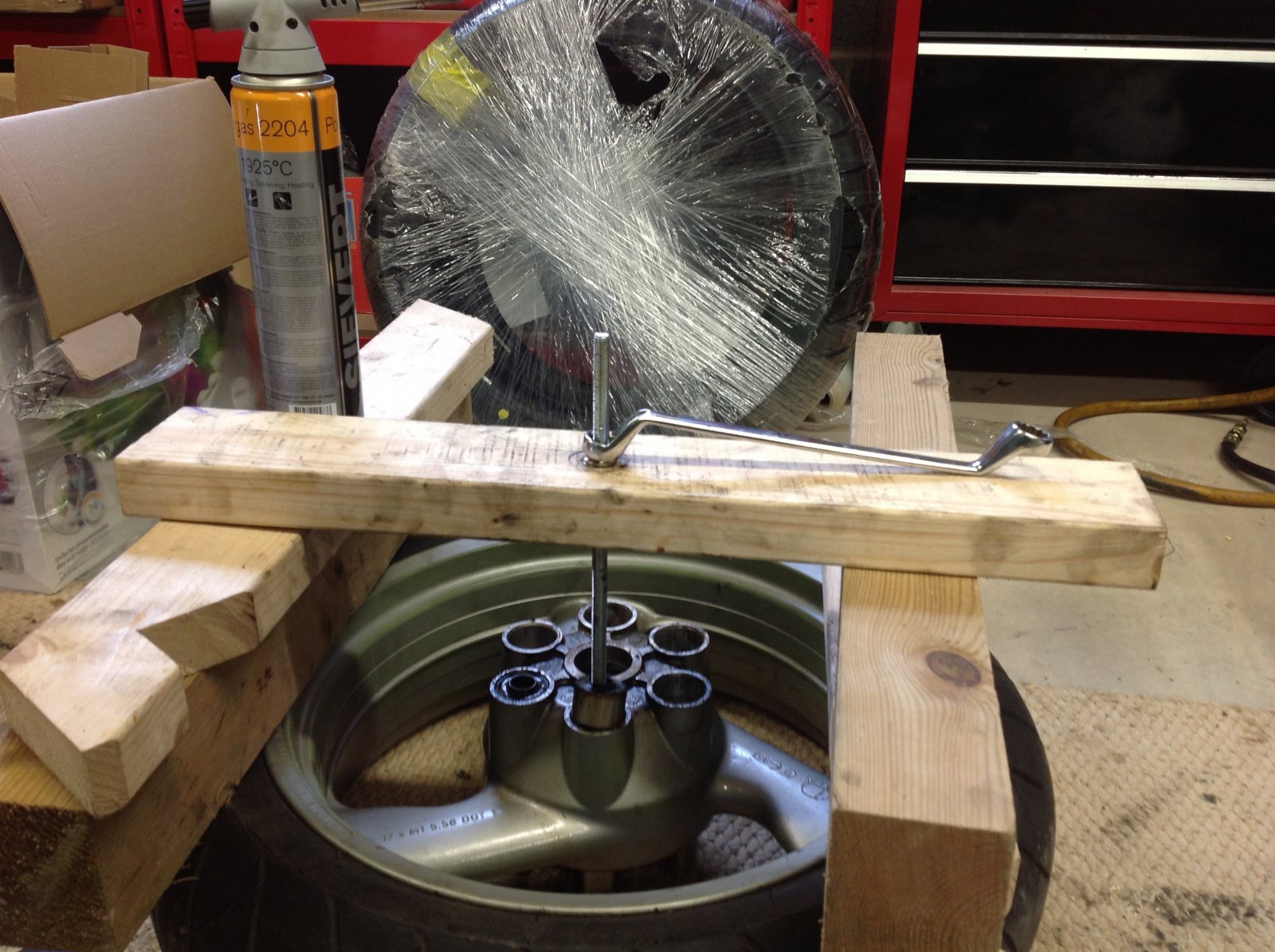

  17. seem to recall somebody on here made this little set up for removing the bushes
  18. I had a gig similar. Its best to destroy the bushes to get them out.
  19. I used some threaded bar and a socket as a spacer a wound them out similar to the wooden jig. Without sounding overly smug they came out really easily on my m900
