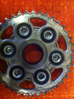

  6. I have just took the sprocket off of the std carrier there is a lip on the sprocket to stop it moving towards the carrier but no lip to stop it moving towards the swing arm...........not surprisingly the same as a 1994 916............
    So in answer to the OP original question you dont have to buy a new carrier, but it is the smarter way of doing business.....and as a by product you can get to change sprocket sizes if required within reason (chain length)
  7. this is the view from the inside
