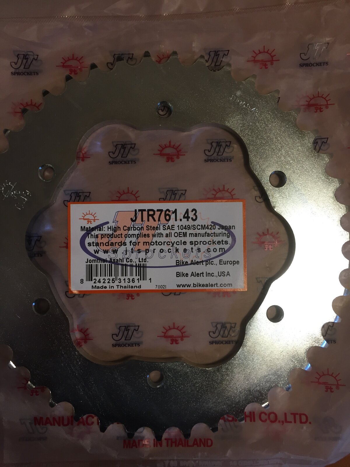

  6. I was told by Ducati (Riders Bridgewater) that AFAM fit the OEM cush drive without a carrier. JT needs a carrier and Renthal too. I THINK Renthal and JT carriers are the same though.

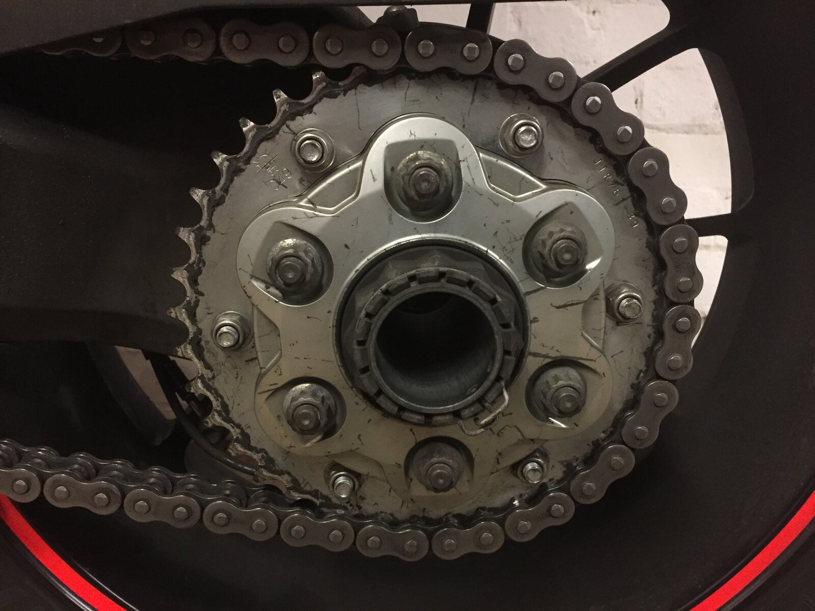

  7. What sprocket have you bought? What is your bike fitted with now? are you trying to change gearing?
    Picture please??
    JT sprocket which sits on a JT Carrier
    discount code
  10. Sprocket set I have now is AFAM. It's stamped on it. I've bought a JT one as part of a DID chain and sprocket set. Existing chain is knackered. Not changing the gearing, no. Just replacing chain/sprox. Still need a pic?
  11. [​IMG]Standard sprocket that does not require a carrier
  12. which sprocket is it like?
  13. Picking it up tomorrow. But am assured it's JT and it needs a carrier. So...I'll post pics tomorrow if you like. Thanks Peter!
    Like this yes? This is mine with the JT sprocket carrier
  15. Notice the extra 6 bolts on the sprocket which denotes it has the carrier:upyeah:
  16. That’s how it will look I’m sure. Will post photo tomorrow. Cheers Peter, that’s been really helpful.
  17. No worries, look forward to your pictures tomorrow.:upyeah:

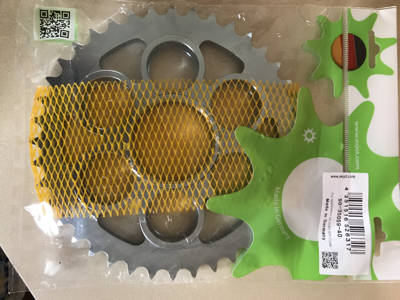

  18. So I went and ordered a JT sprocket carrier from UrbanMoto who were super-efficient in getting it to me overnight! Pick up the chain and sprockets only to find that while the FRONT is JT, the rear is ESJOT and doesn't need a fookin' carrier (See photo)!! It was £60 too, wonder what the restock fee is.... :( 2019-06-05 15.53.27.jpg
  19. Quick Change Carriers are primarily made for the track or for those that change their gearing often and even then.
    If you don't, you're wasting good money. You can buy several sprocket sets for the price of one carrier/sprocket combo.
    Of course, if your reason is bling, "skies the limit" and I withdraw my comment.
