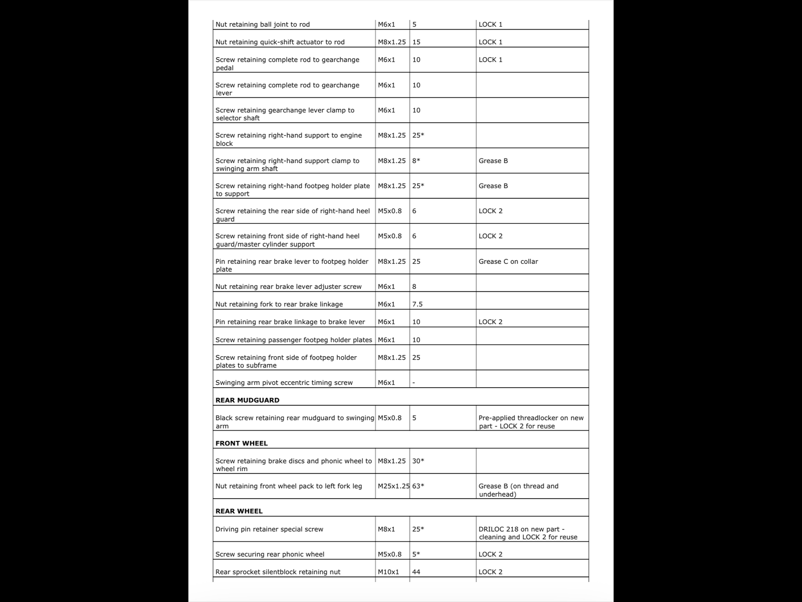

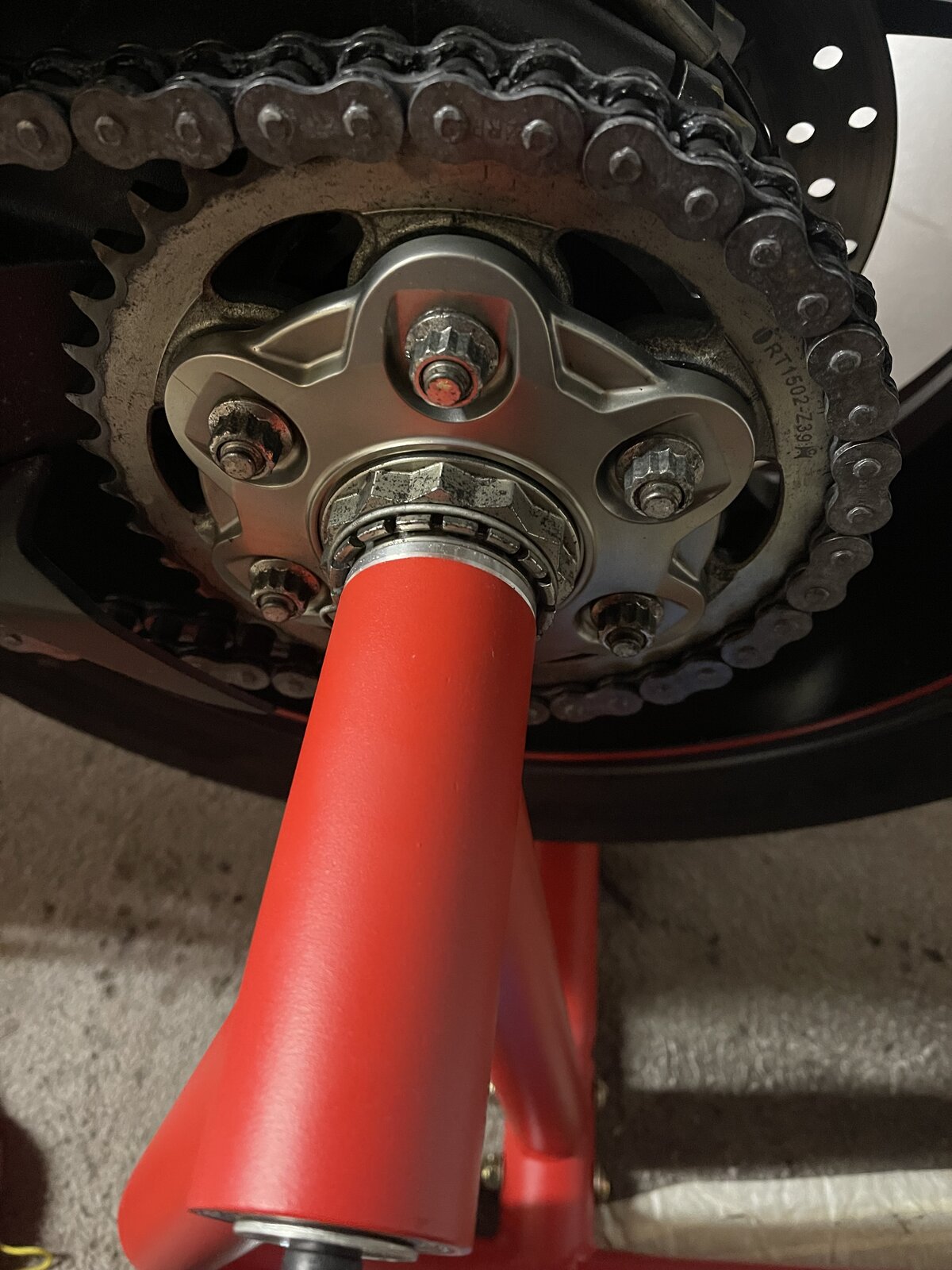

  1. Apologies if this has been answered before I have searched the forum and I think I know the answer, but I wanted to double check with everyone, the 6 sprockets nuts on the 1299 need to be torqued to 55 Nm is this correct ?
  2. 44Nm I think…
  3. Thank you looking at my sheet of torques I may have confused the front sprocket torque
  4. 44Nm is correct.
  5. Dont forget the locktight... medium is what you need there
