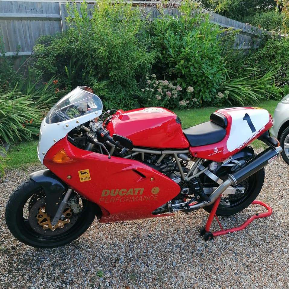

  1. Hi all,
    On my return to Dear Old Blighty, I connected the battery to the FE (which had been sporadically on and off an Optimate.) On turning the ignition to P, I had bright idiot lights and fully functioning headlight and rear light. However on turning the ignition on, there were extremely week idiot lights, no sound from the fuel pump and no chance of the engine turning over. Nada!
    A local mechanic tested the battery and confirmed it was in fine fettle which has been confirmed by the parking lights functioning.
    Has anyone any ideas please? Appreciate the help.
    Regards,
    Richie.
