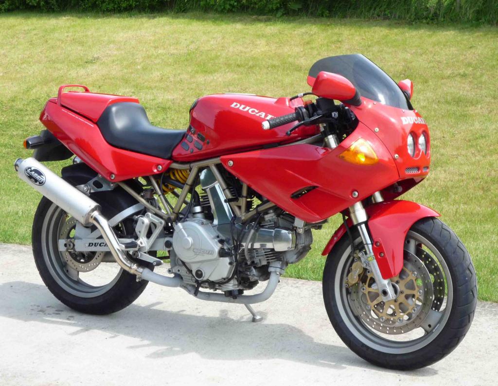

  4. I've fit a high level Sil Motor can to my 600ss with 750ss downpipe. The l/h exhaust outlet removed and blanked off.
  5. I run Hi level SL cans on my 750... for a high level on the 600 i used a FZS600, viper link pipe with whatever end can I fancied...
  6. Don't suppose you have any pics??

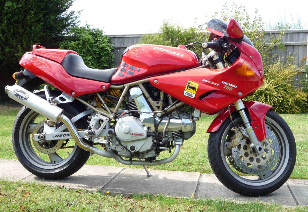

    Thats the 750ss :) I havent any of the 600 on my computer at the moment, will add when I have them.

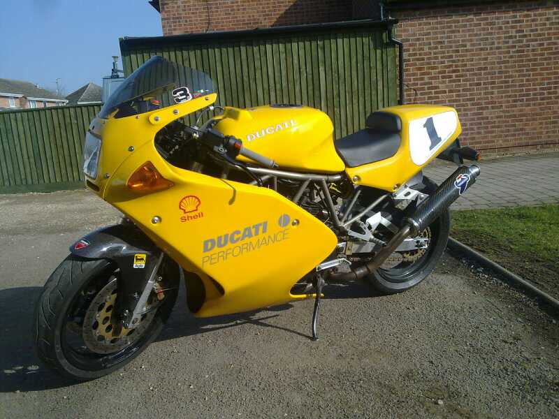

  8. Hi level pipes? Here ya.....these are on my 750......the same system, but I changed the can covers from ally to carbon.
    AL
