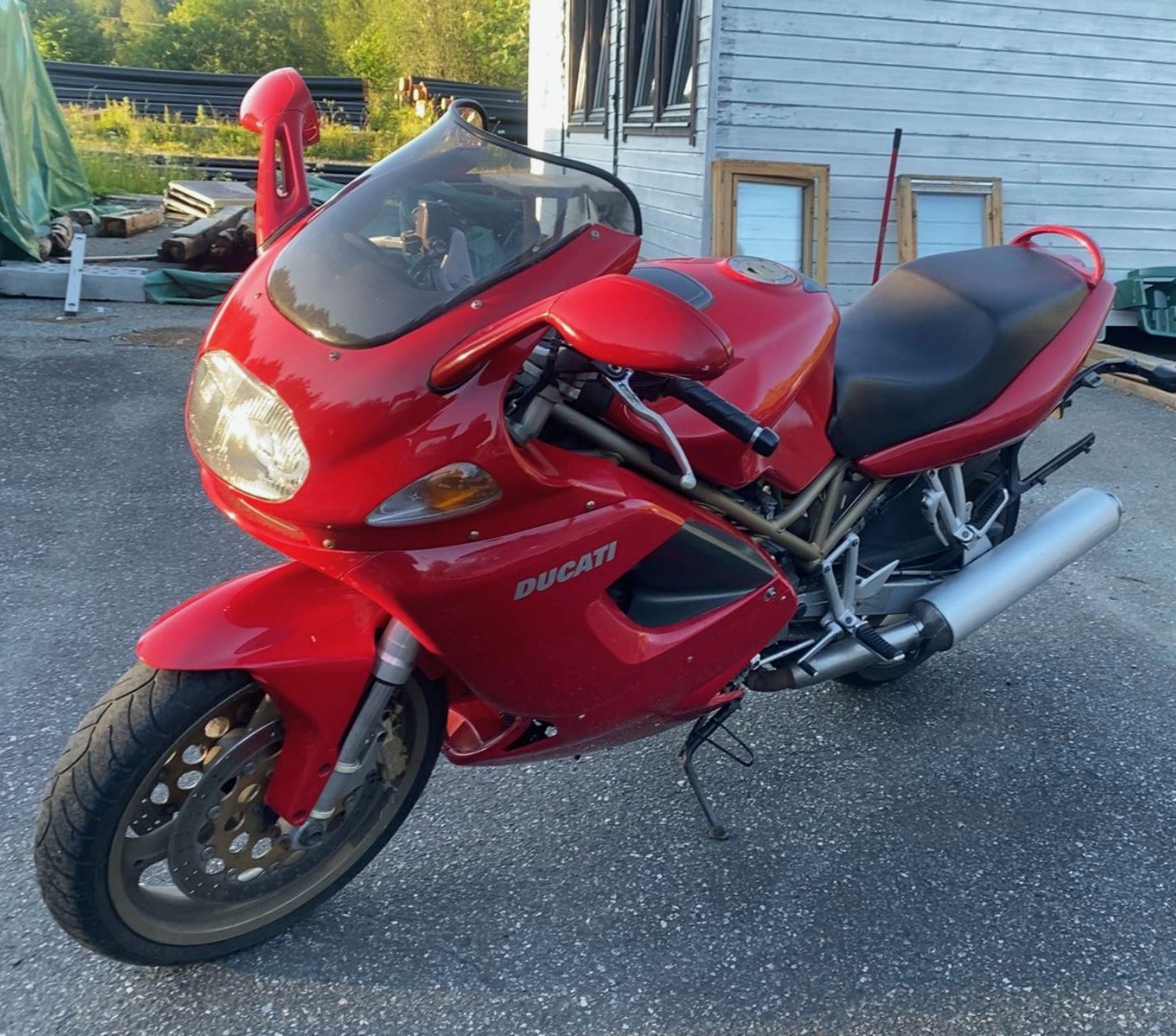

    I just bought a Ducati ST2 1998 model and I am reviving it.
    It has been standing for 5 years, so I made a bunch of service at a Ducati workshop and try to fix things by myself now...

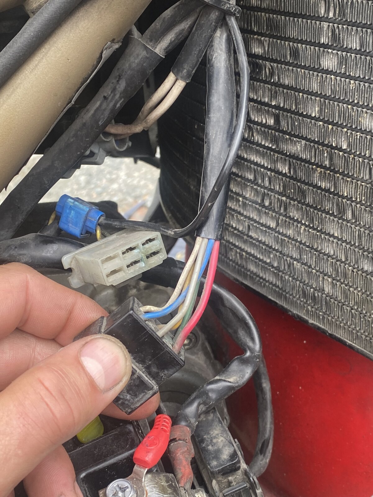

    On a second thought, since I nowadays also have the MTS 950S, I've decided to remove all touring related stuff from the ST2, and put on the very loud carbon fiber silencers...so I will probably not hear the noisy clutch anymore...!! :innocent: :laughing:

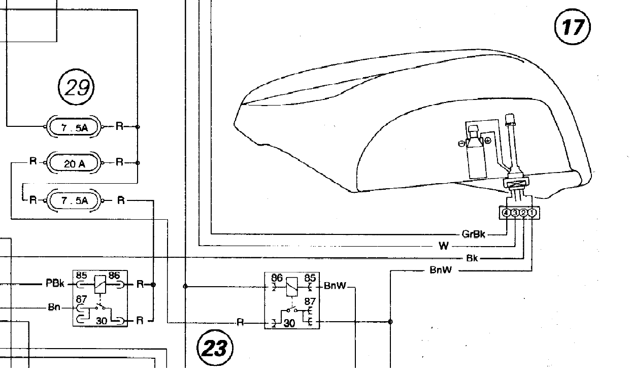

    With no relay there is no way the pump should get 12V. You may be on to something with the ground wire. If you have 12V there, and get 12V via the relay, the pump won't run, because you have 12V on both sides of the pump. ST2 pump.png

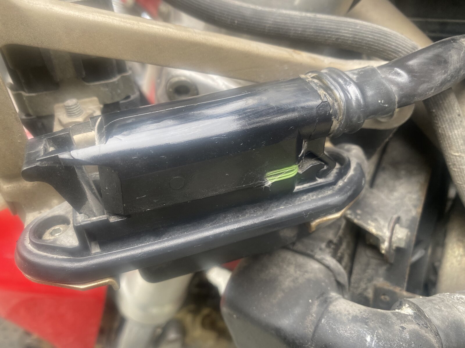

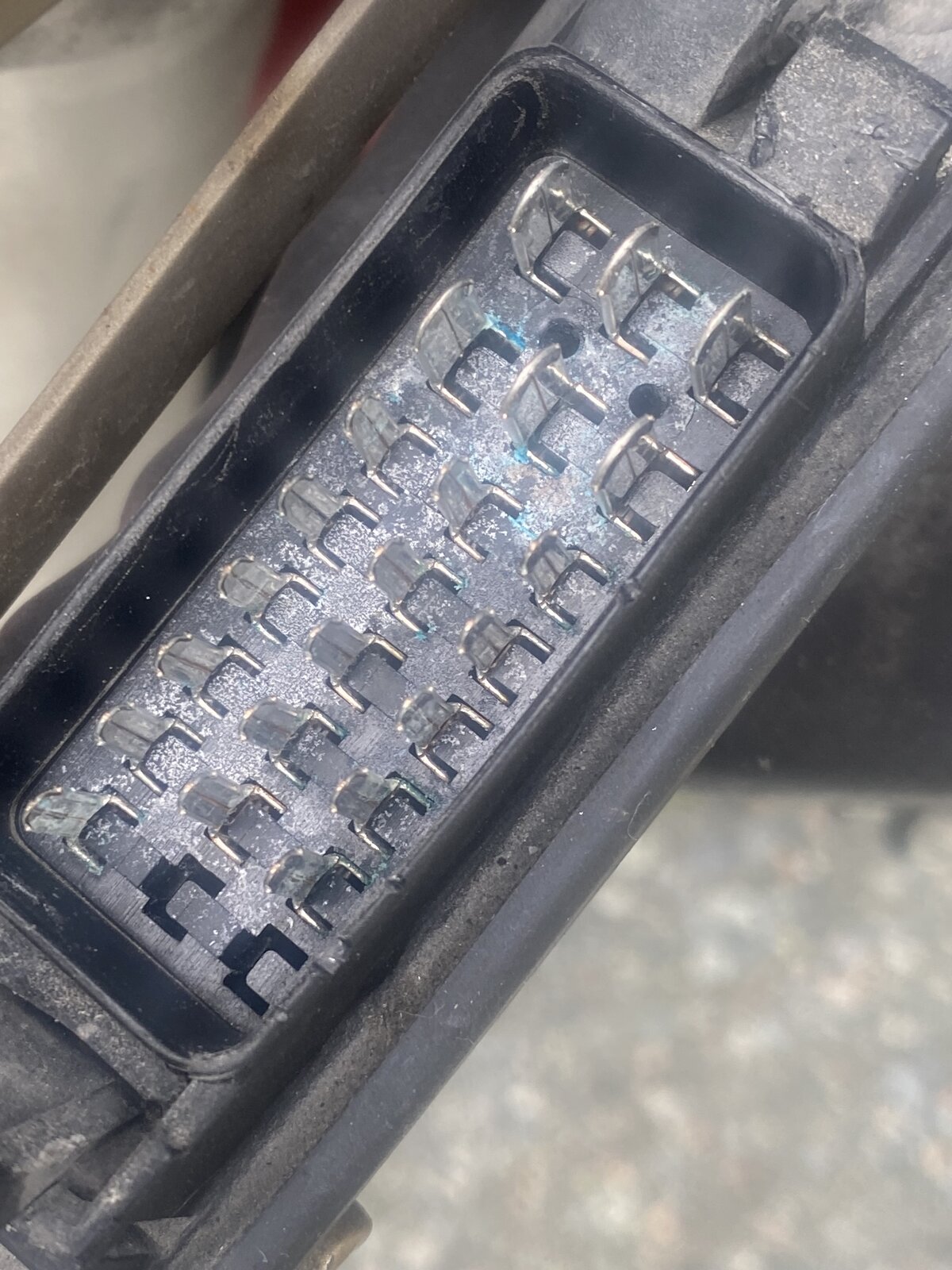

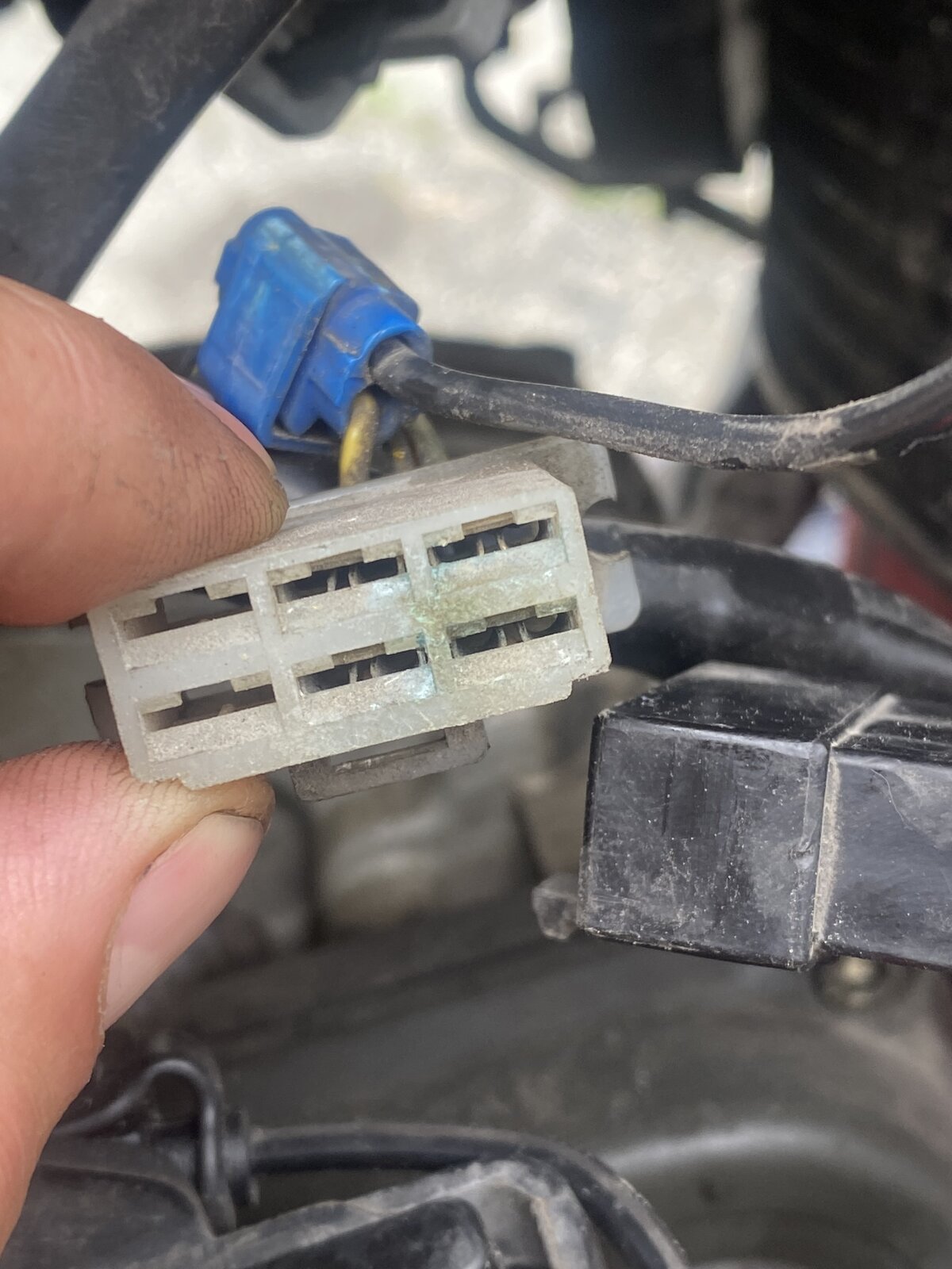

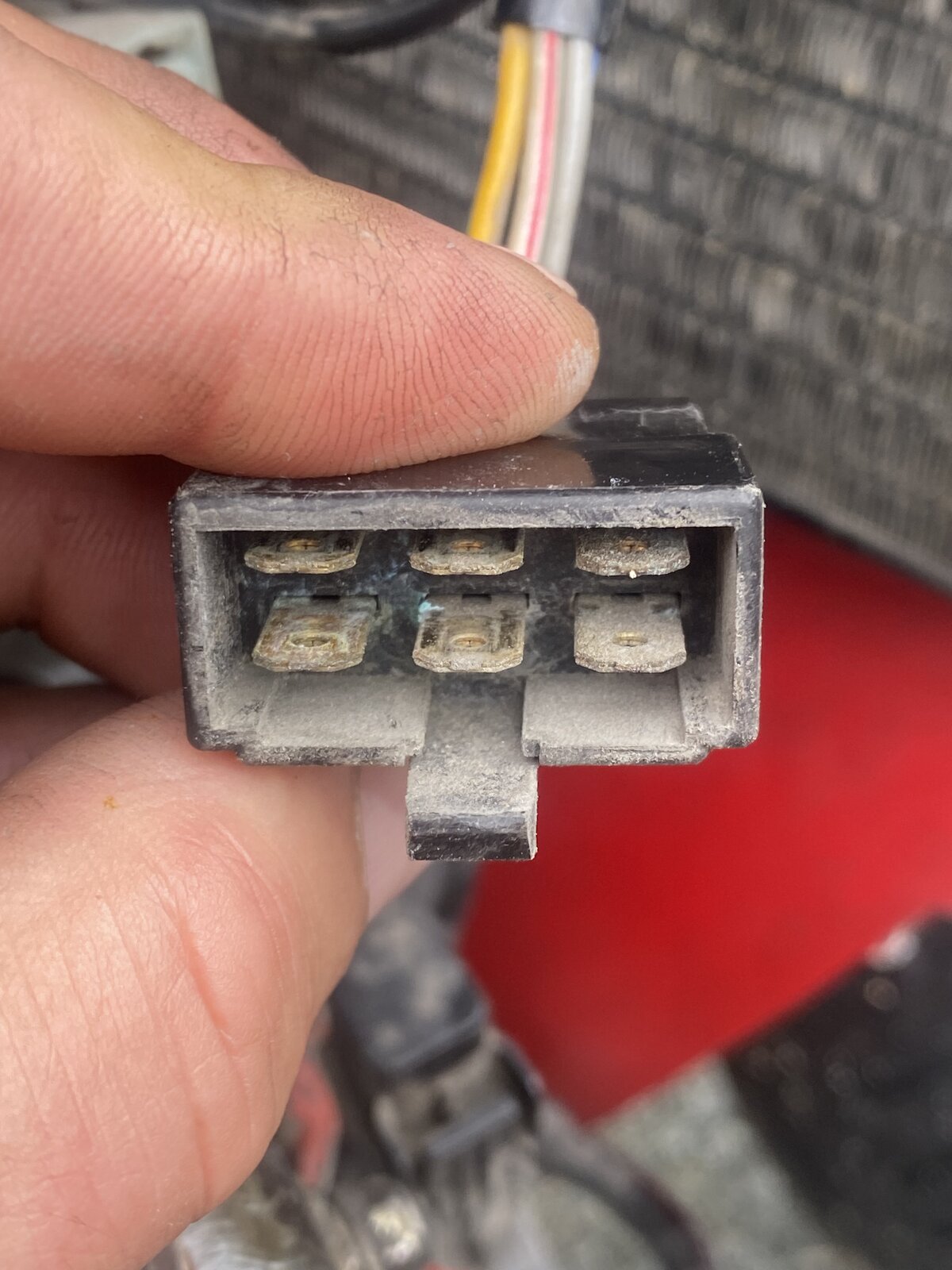

  18. I am changing the all back harness loom. The large front left connector was broken when I bought the bike and full of white/green oxidation. Same thing on the connector from the regulator on the right side, third thing, the connection from the stator to the regulator was burned. I imagine that all that together can have lead some wires to melt together somehow inside the harness loom. But anyway, I can’t just change the left connector, so I have ordered a new harness loom from eBay. I already got it and I looks much better than the one I have on the bike. Not so “dry” and stiff. My St2 has been in storage for 5 years and I can imagine that the wires have develop some rusty welding points etc. my hope is that the ECU is still good. The bike was going fine until it got a bit of rain. The day after that, no priming, no spark and probably no injectors either. It already has some difficulties to start when I got it though…
