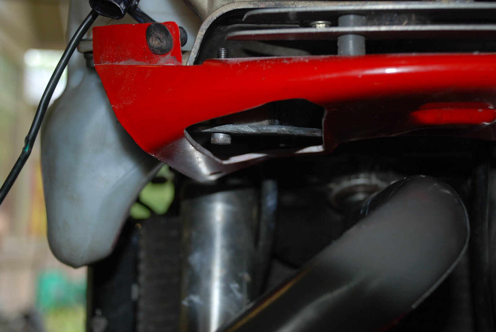

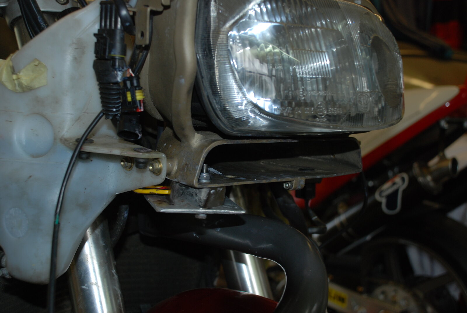

    The Electrex RR50 is MoSfet based however I've added a 10mm x 110 x 80 aluminium plate to the resin side of the unit to act as an additional heat sink with slots cut in the fairing cheek piece to maximise airflow.
    The effectiveness, or otherwise, of this will be revealed with time.

  9. Well, it seems the Electrex RR50 with added heat sink and fairing slot has proven to be successful, at least for the 400 mile the owner has clocked so far.
