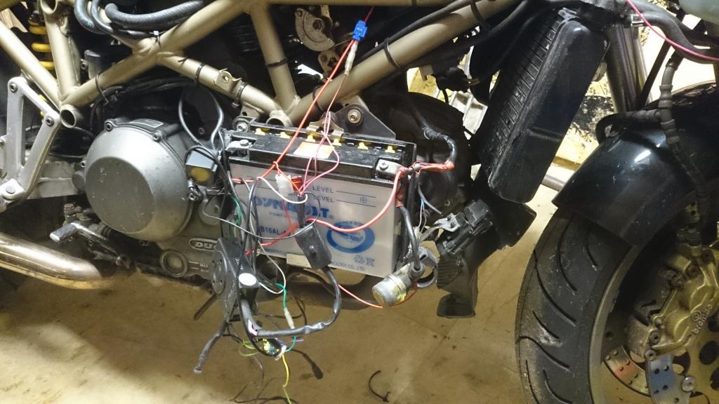

  5. DSC_0063.jpg Check out the state of this alarm too!! Anyone had the joy of removing an alarm like this?

  7. My 916 has a datatool on it. I would love for it to be removed. I hate the damn things.
  8. I might try to remove it if I can find some advice about it online. I'll do a thread on it if I do so watch this space!
  9. There was an alarm fitted to the 1098 loom I used on my recent build.
    I simply followed the wires into the loom, pealed tape, snipped and re-soldered.
    Not too onerous, just takes a bit of care.
  10. Did the same on my ST4 project. Just cut out and re solder, job done.
  11. I also did it on a 749. Don't solder, it'll break. Use decent connectors to hook it all back up.
