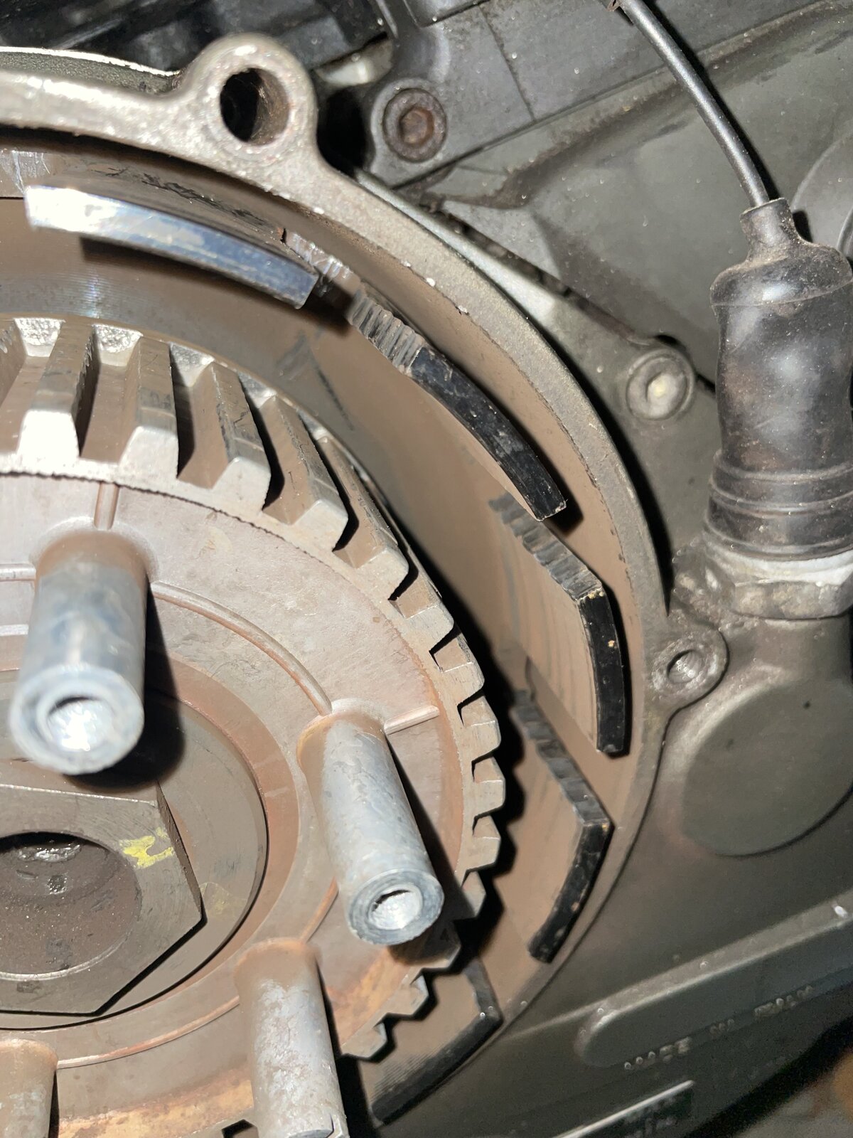

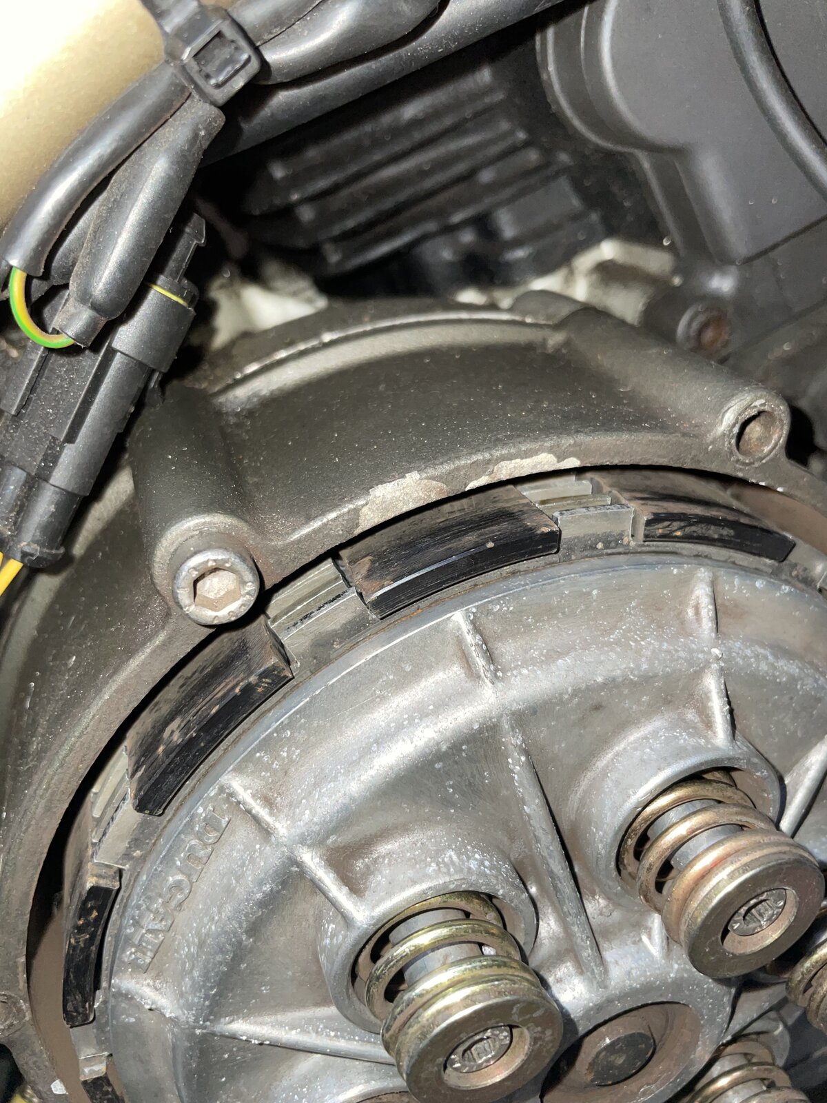

  14. Have you taken the clutch plates out and examined the clutch basket for notchy grooves? And likewise the tangs on the plates?
  15. Well I had a look and took a couple of pics… I have seen worse, but there are some grooves in the basket.
    8017F604-49E1-46CD-B43E-EFDC397D52E9.jpeg 4C581E64-C98A-4E4D-8CDA-E901DE86C3BC.jpeg
  16. Okay, I gave the whole clutch and basket a good clean to improve the lever feel. The grooves are simply not deep enough to start worrying about that, so after I put it all back together I filmed my attempt to pull away... I am restricted to a very short section of covered drive way:
    The video shows the rather dramatic 'clunk' I have been experiencing. It's not the kind of thing you want to be doing too many times. Also (as mentioned before) I tried a few more revs and more clutch slip, but it doesn't help. Still the clunk.
    Thoughts very welcome.
  17. Thanks for that... That's a proper pain to replace, but done it before on a 748, so at least know what to do. With the 748 it was more a rattle on starting than a stall, so does that mean there is a little more damage in there?
  18. It's an unusual one as you seem to be able to start every time practically as normal. I've not experienced first hand but have heard several times how a distorted sprag clutch can cause unusual noises while engine running but yours is actually a "jam" severe enough to stop engine so best to hope that others reply having experienced this exact symptom.
