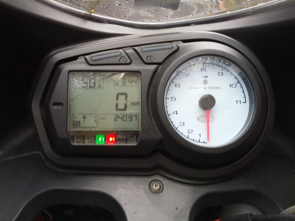

  3. Got a picture? I think if it's the double pod style the speedo and rev counter split into two pods

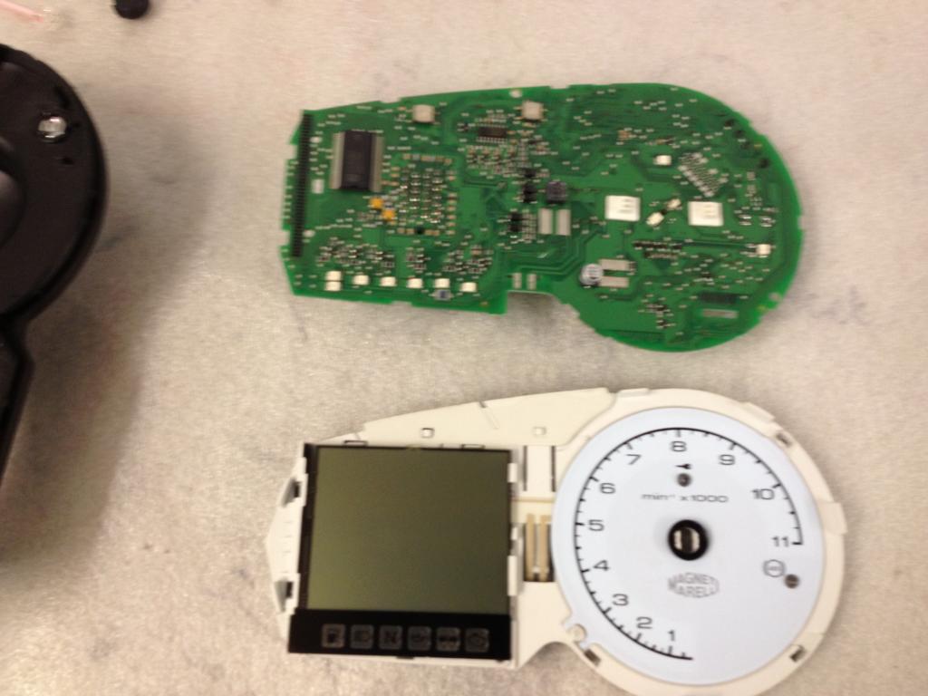

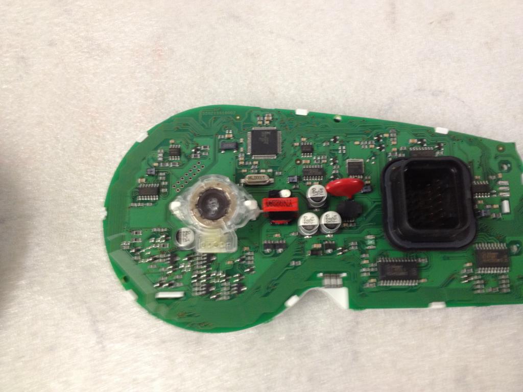

    Stripped down a spare dash I've got - few pics to show the insides.
    As Android stated the dashes are prone the water ingress - I shall be sealing mine if I can fix the LED.
    The dash is held together via 4 small Phillips screws, once removed you need to prize the 2 sections apart (Several internal clips).
    To split the 2 sections you need to remove the rev counter arm - again this prizes off (Be careful).
    Then unclip the white clips, the boards are attached via flexible part of the PCB and a metal clip.
