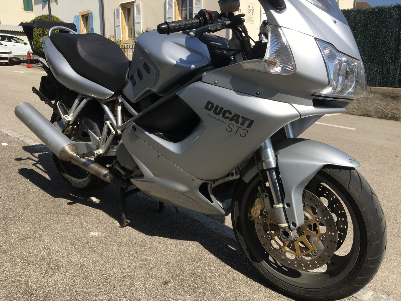

  7. Many thanks for the welcome ... photos are always good !! Touring mode.jpg speed mode.jpg

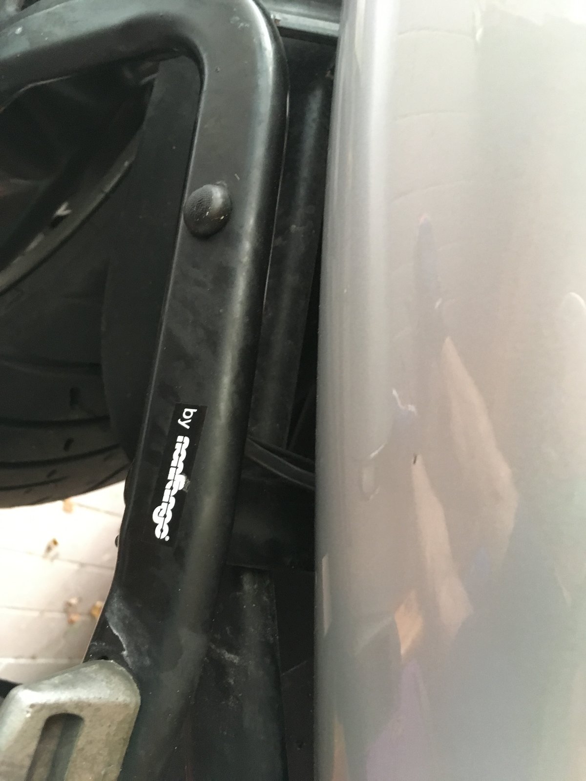

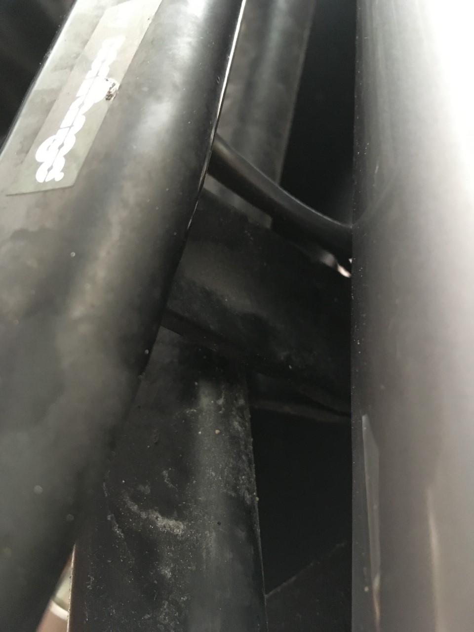

  10. Hi Ciaran Could you send some pics of the way the top box rack is fitted to the rails?

  13. I luckily managed to source the Nonfango rack and it connects on to the rear indicator's bar on the underside of the fairing ..hopefully the pics will help duc topbox _1.JPG thumbnail_IMG_4013(1).jpg ducati topbox _3.jpg
