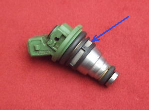

  1. When I took the spark plugs out the front was a good colour, but the rear was very black. Additionally on removing the air filter (that is supposed to have done 500miles) it has a dark stain over most of the inside above the rear throttle body. When I blip the throttle I can see fuel ejected back out of the rear throttle body. The front throttle body doesn't do this. Also I get the impression that fuel consumption and throttle response at low revs has been detiororating....
    Seeing a similar thread I have checked the cam timing. The timing marks on the pulleys all line up as they should. I have pulled the rear injector, suspecting maybe a seal had gone allowing fuel to seep into the throttle body. The o-rings look sound. Is there anyway I can check the injector, or might I be looking in the wrong place?

  3. I can certainly try that. 2 questions though:
    1) If they werent spraying properly, wouldn't that make the rear cylinder run lean rather than rich?
    2) All the you tube videos show injectors where the fuel goes in through the top. Not sure how I could rig up a pipe to get the fluid in here.[​IMG]
  4. That will prove problematic. Possible solution would be to back flush it.
  5. Chris, Thanks for the offer. I think I have sent you a message about an injector connector.
    I was wondering is it possible to remove the filter from the injector and replace it without damage? Anyone done this? Reason being that the casing would then make a nice cup for holding cleaning fluid while cleaning the injector.
    I'm nervous just to prise it off without knowing how it is constructed. I may just end up breaking what may be a perfectly functioning injector!
  6. they can be a total pain to remove the whole injector but if you manage to do it with relative ease you could swap front for rear unit as a lazy but easy check on function.
