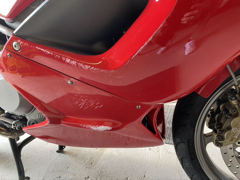

  1. Disaster struck last weekend gents! I was enjoying a lovely ride out when the bike stalled and just wouldn't restart! On pressing the start button, everything is dead, no lights on the dash…nothing! And to top it off, a huge gust of wind blew it over causing panel damage :mad:. It took 6 hours waiting for the RAC to get back home!
