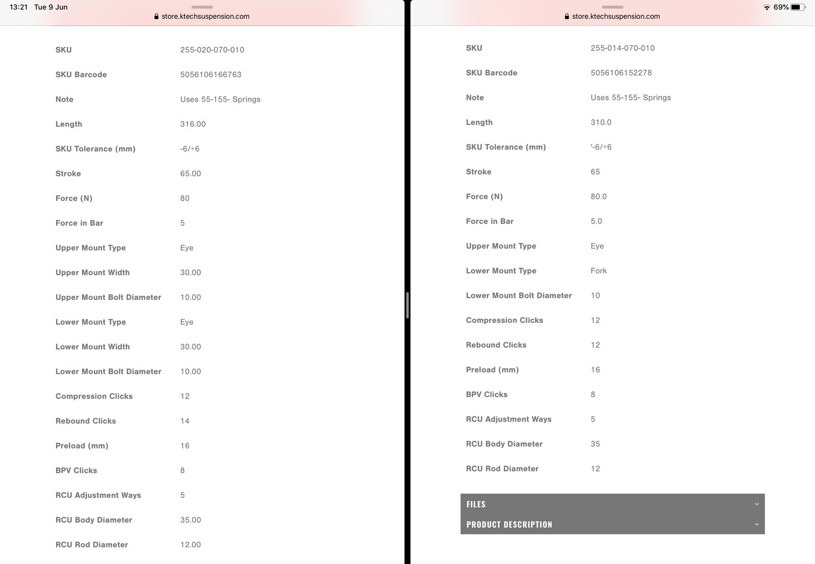

  1. Anyone know what the standard rear spring rate is on the V2? Tbh I assume the same as the 959 circa 85nm? I can’t see it written on mine but it may because the spring has twisted around to the back.
  2. When I researched this for the 959 I found information saying the stock spring is 78nm.
    The Ktech replacement for both bikes has an 80nm spring but the V2 shock is longer - see below V2 on the left.
