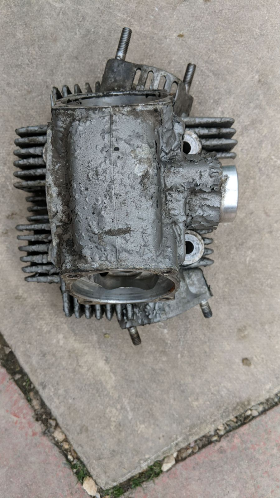

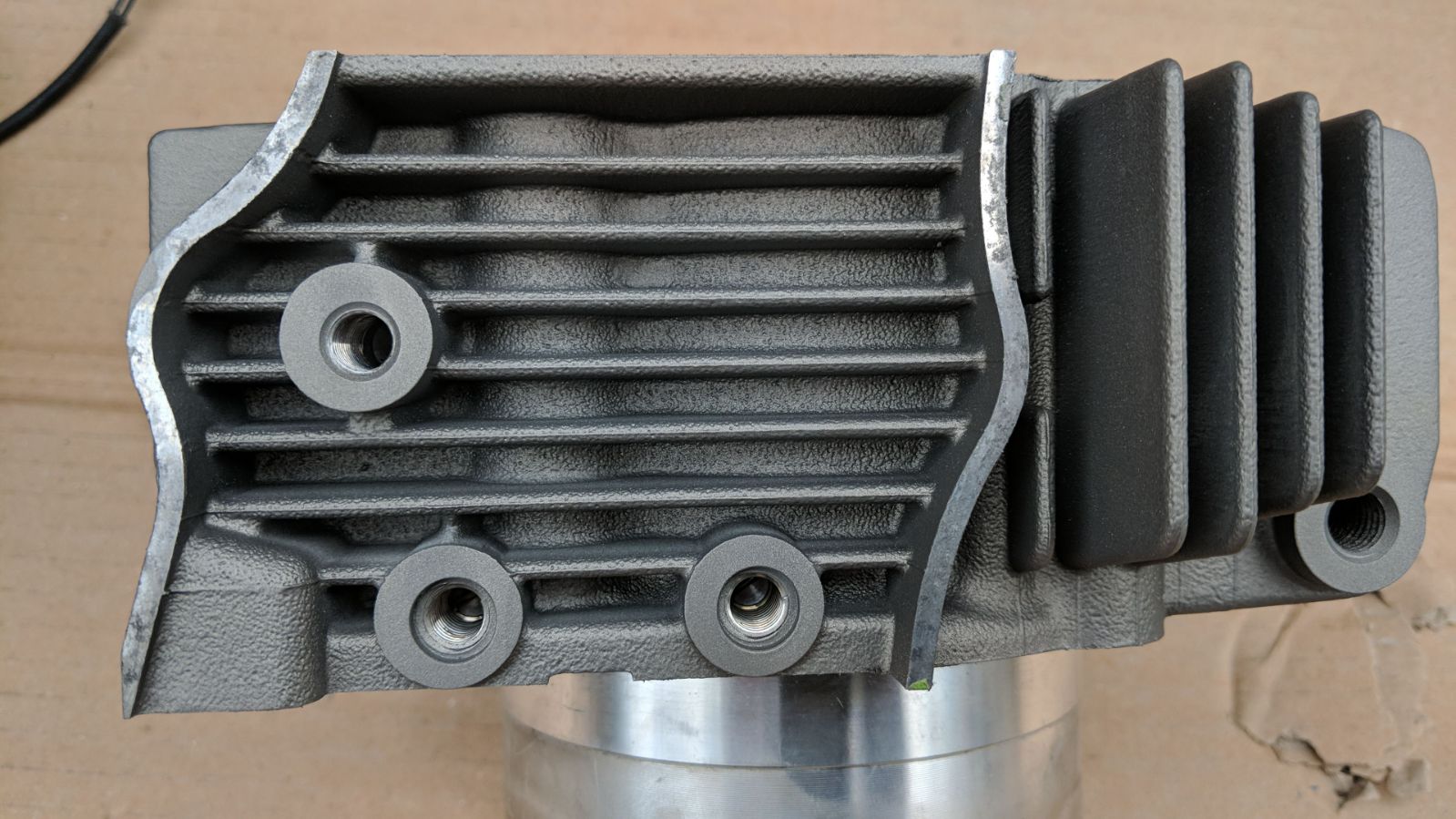

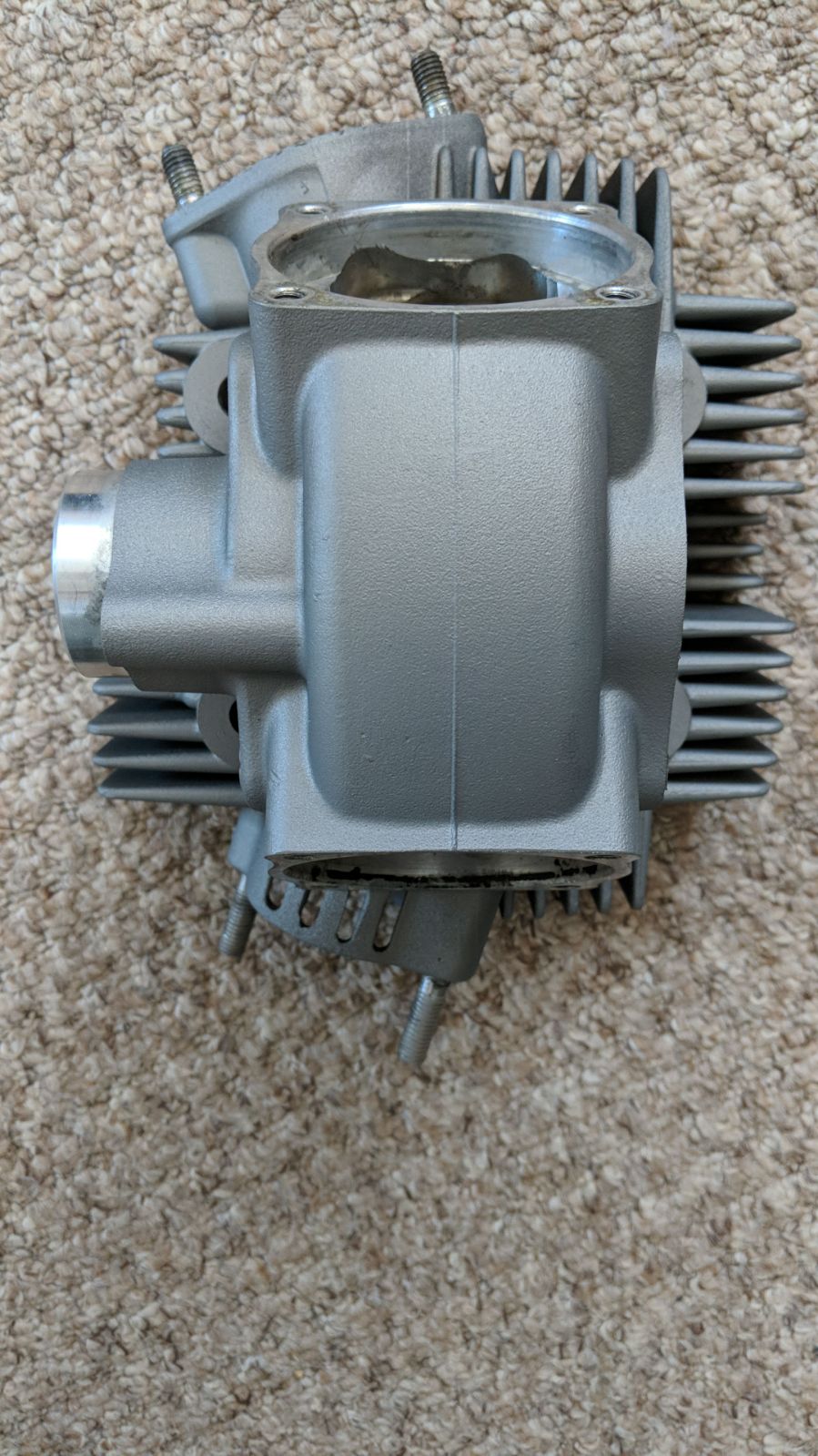

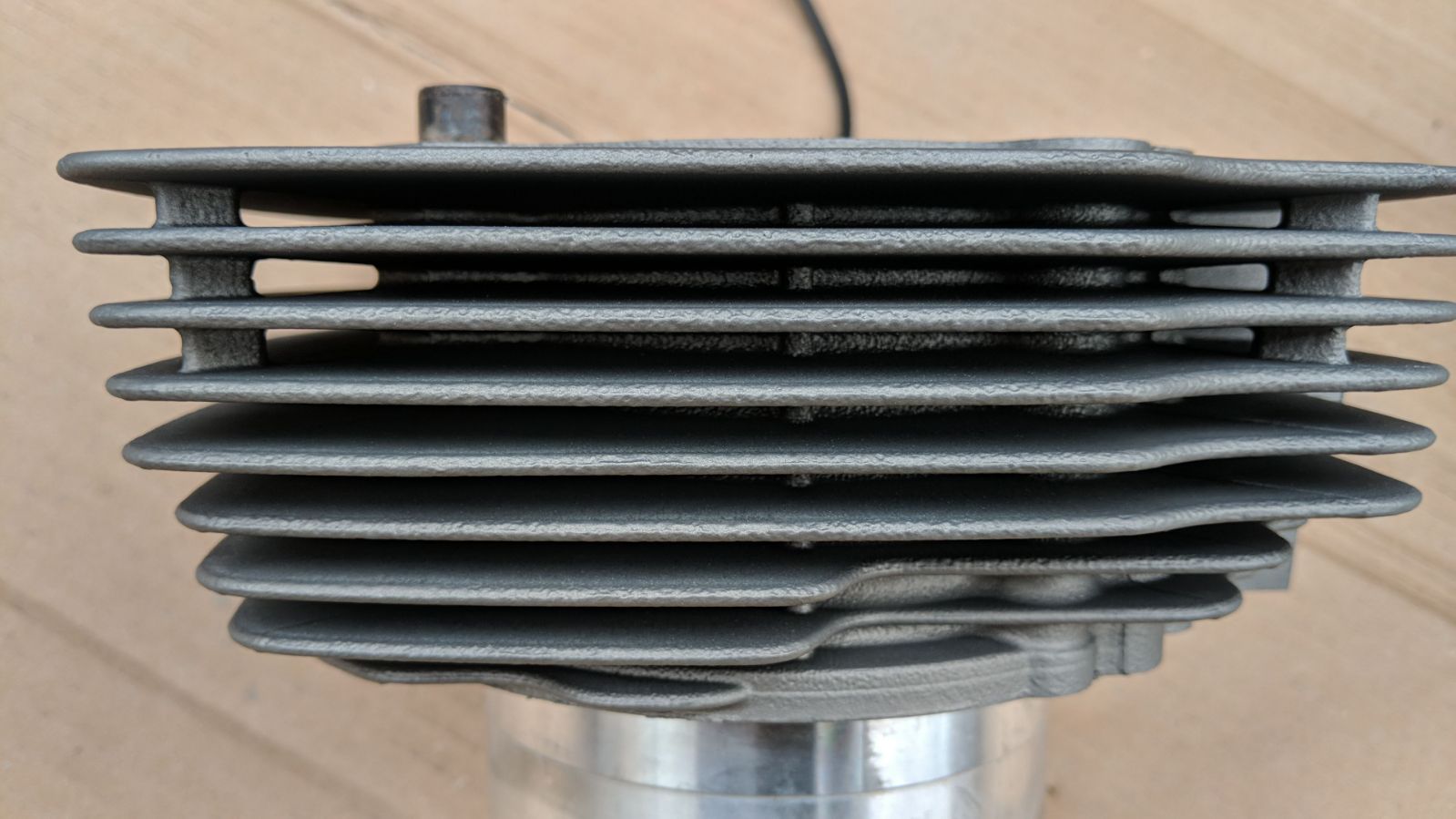

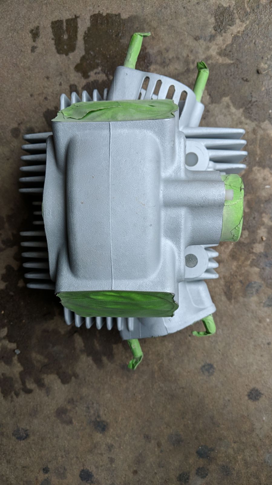

  3. Was just about to say that.....took mine back to the crank cases and had it cerakoted....18 months on and no flaking atall.
    A few before and afters...
